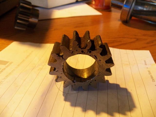

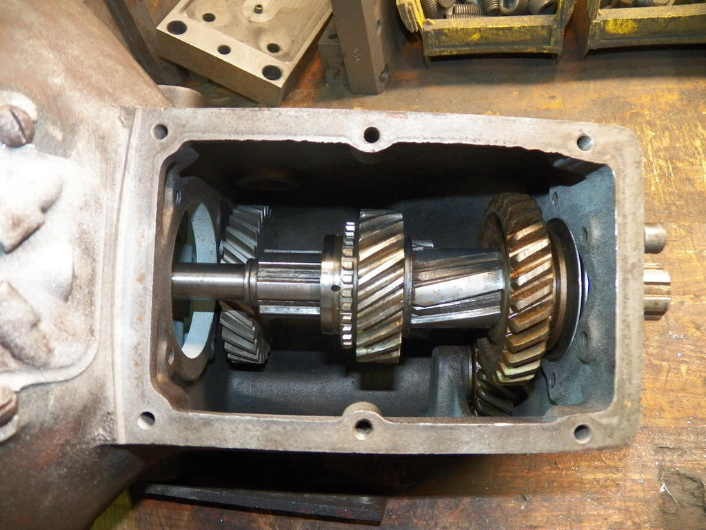

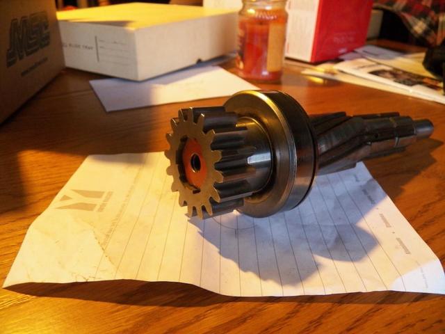

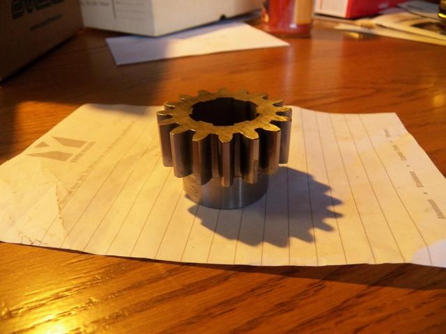

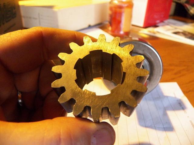

buckrancher 2,697 #155 Posted April 24, 2015 Made a new tail shaft gear for the output shaft on the transmission I bought a gear that was longer than the original and cut It down to the length I needed then I had a coworker who runs our wire EDM machine cut a internal spline to fit the output shaft here's the old gear that I cut off the output shaft new gear this gear now takes up the space that gave me the slop in the original trans setup I will use a harden washer and bolt to attach to output shaft Brian 5 6 Share this post Link to post Share on other sites
rmaynard 17,540 #156 Posted April 24, 2015 It somehow seems unfair that you have better toys than me. As usual, great job Brian. 2 1 Share this post Link to post Share on other sites
cstempert 27 #157 Posted April 24, 2015 Brian Looks great That arrangement is similar to the original where the splined shaft would have used a speedometer gear and then a slip yoke retained by a bolt/washer to hold the bearing and shaft in place Hopefully there's enough room for the bolt inside the secondary case Share this post Link to post Share on other sites

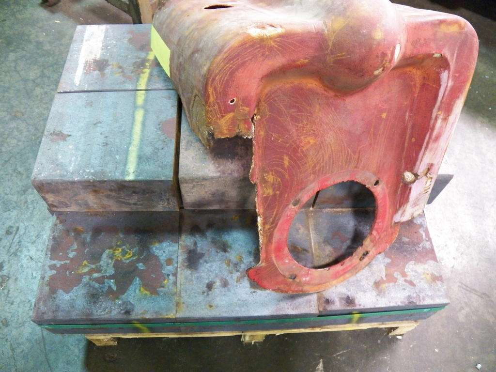

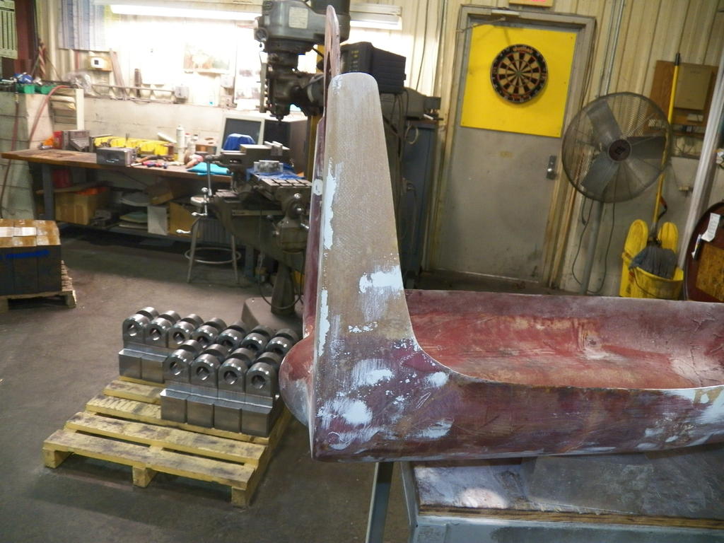

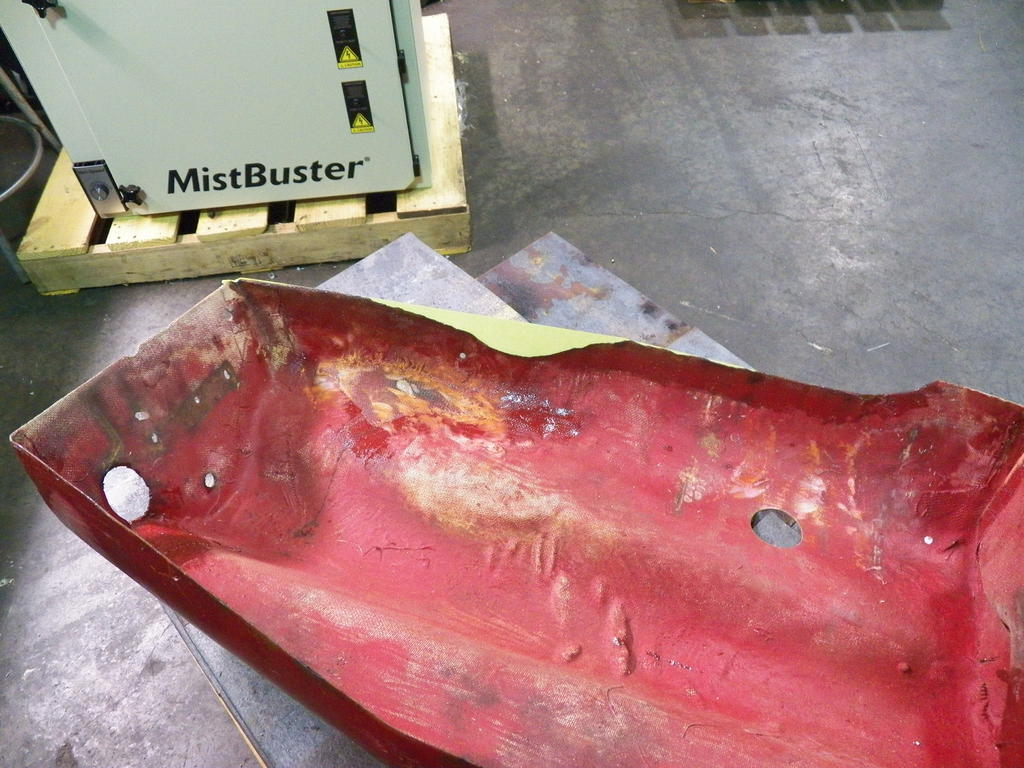

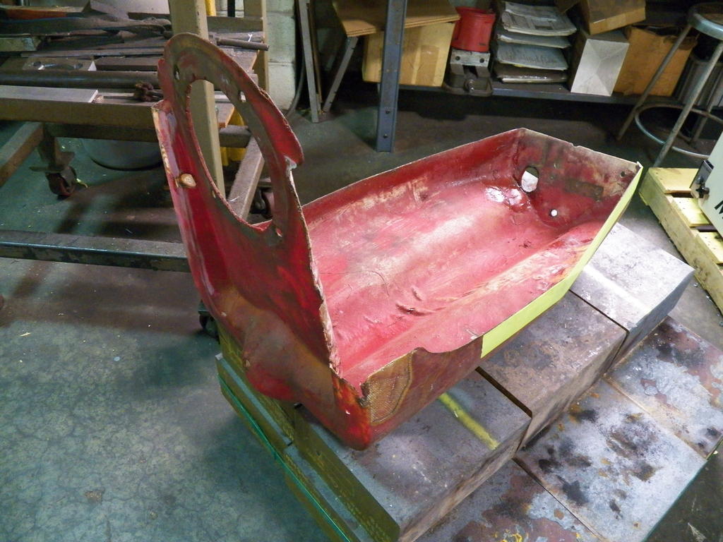

buckrancher 2,697 #158 Posted January 14, 2019 finally getting back on this project I'll see what I can do with this hood 3 7 Share this post Link to post Share on other sites

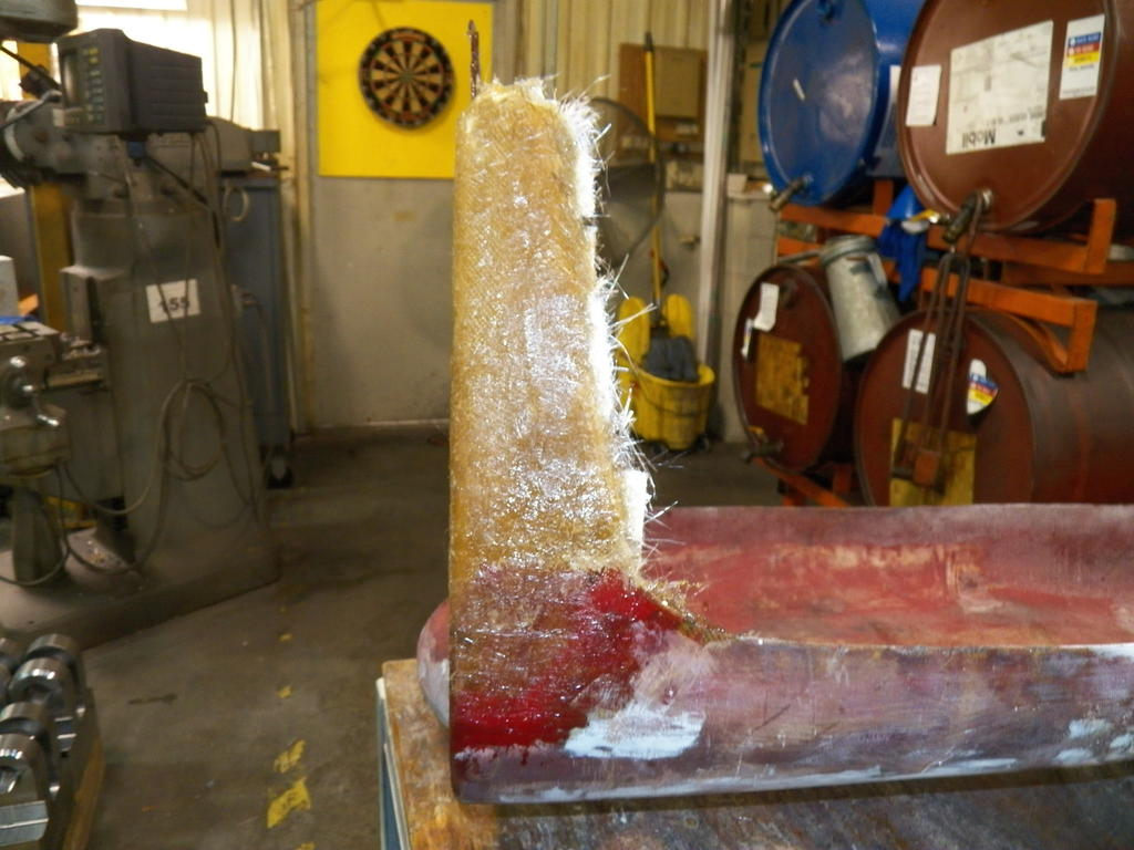

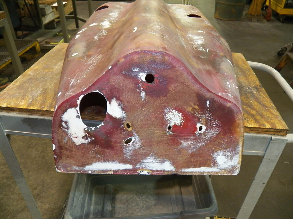

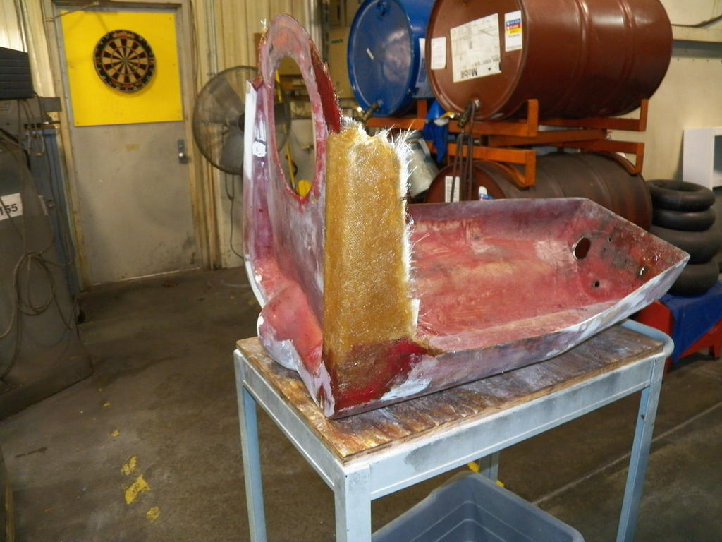

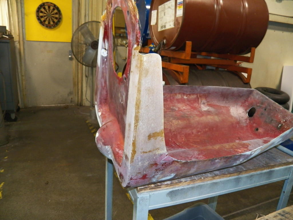

buckrancher 2,697 #161 Posted January 14, 2019 I made a form from a couple of 2 x 4 's of the front corner of the hood put a plastic bag over it laid up two layers of 6 oz fiberglass cloth then married it into the hood on the broken corner then added two layers of fiberglass mat to build the thickness up Brian 7 3 Share this post Link to post Share on other sites

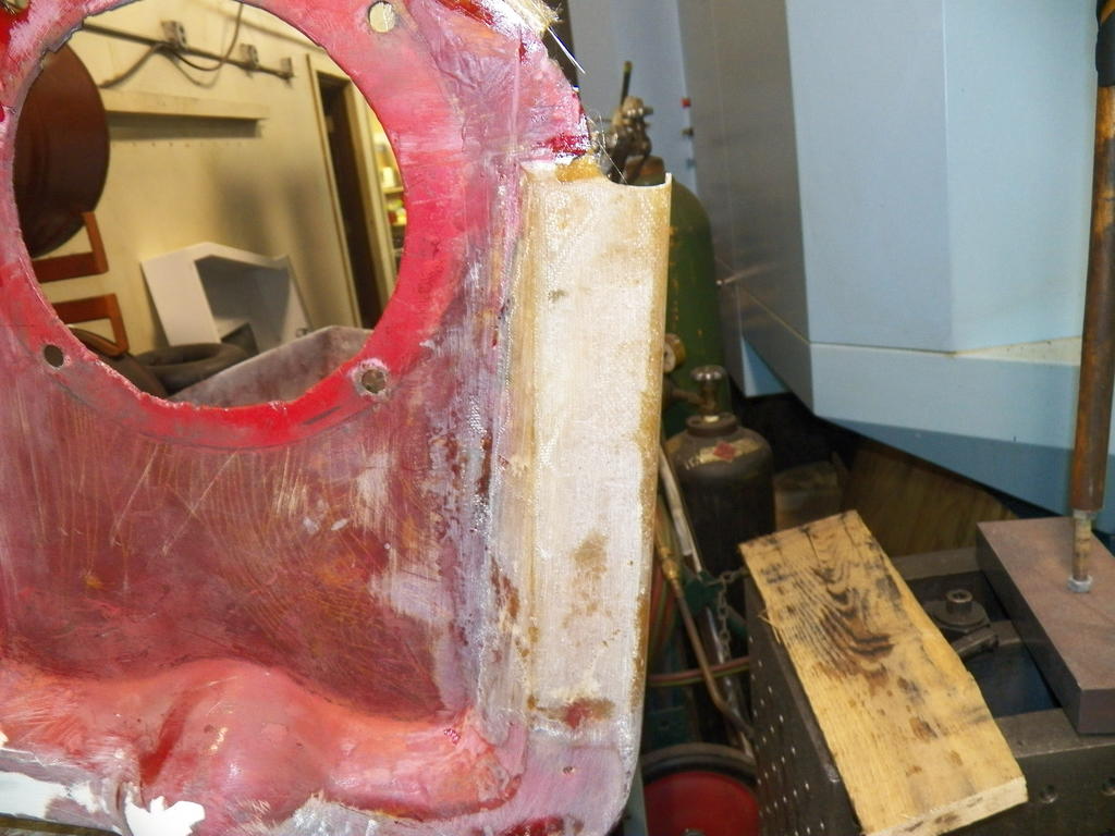

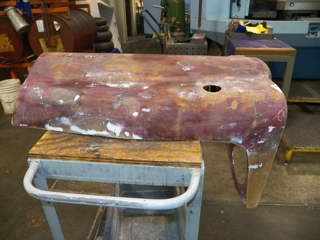

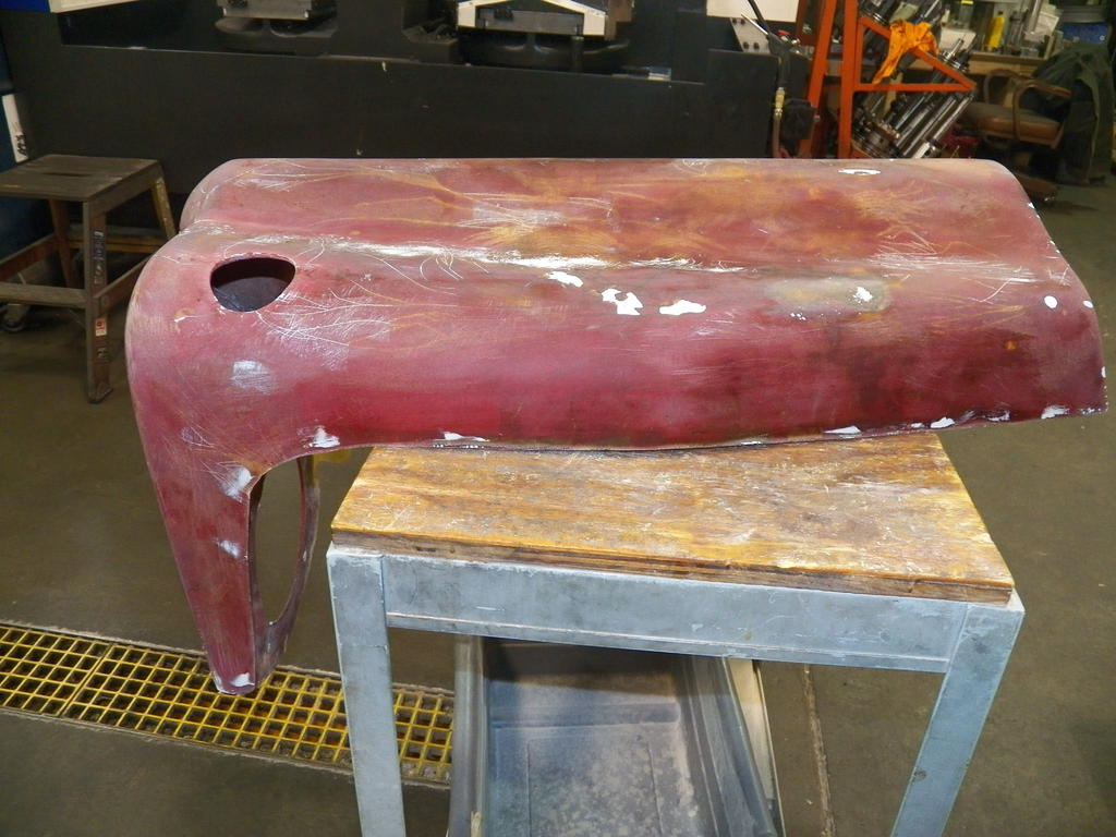

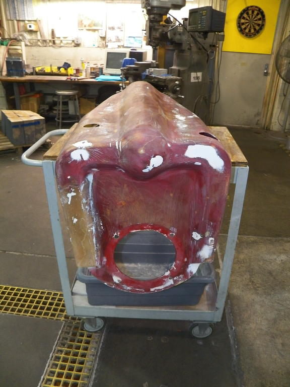

buckrancher 2,697 #163 Posted January 18, 2019 block sanded and cut to shape should have it ready for primer soon brian 8 6 Share this post Link to post Share on other sites
19richie66 17,932 #164 Posted January 18, 2019 Very nice! That's probably stronger than it was from the factory. Share this post Link to post Share on other sites

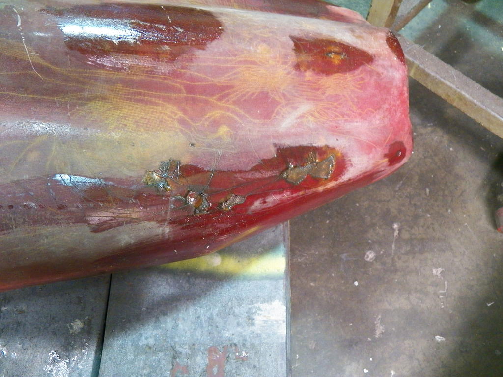

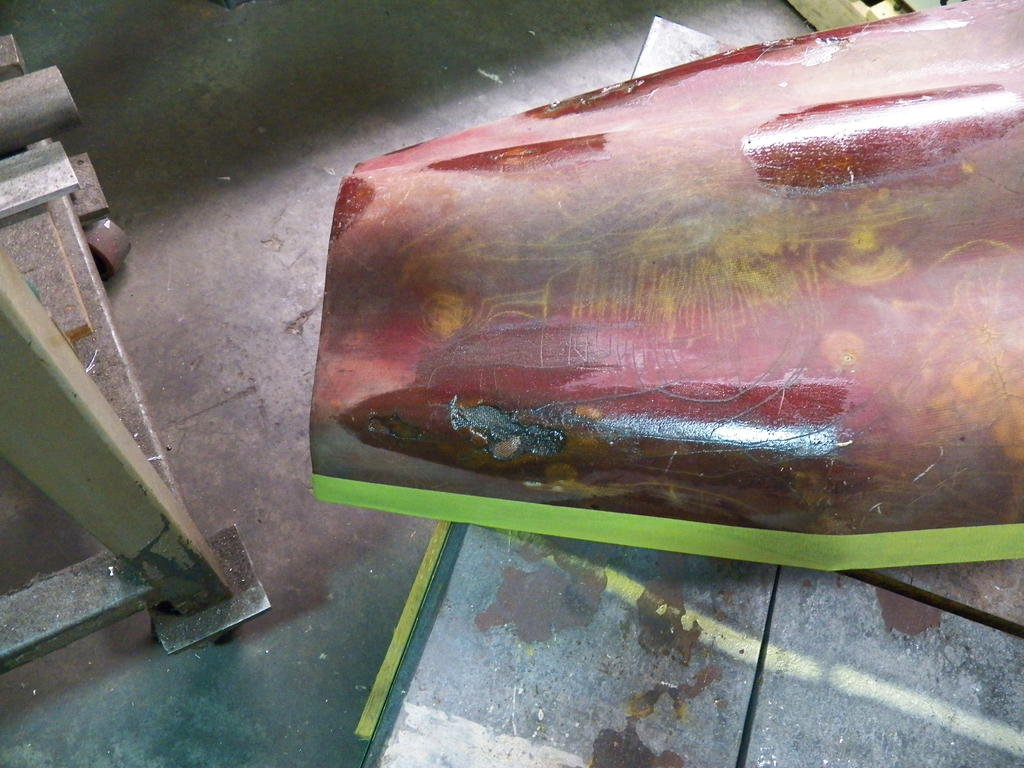

buckrancher 2,697 #165 Posted January 20, 2019 I believe it's ready for some primer all holes have been fixed 4 12 Share this post Link to post Share on other sites

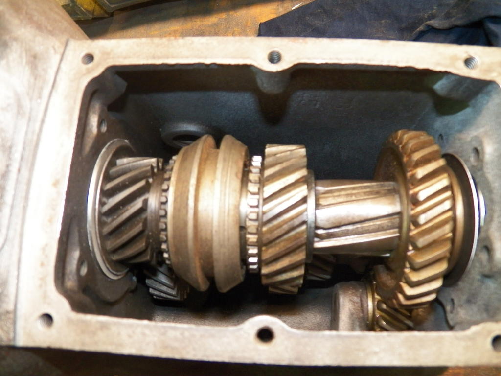

buckrancher 2,697 #170 Posted April 10, 2019 got the transmission back together 3 12 Share this post Link to post Share on other sites

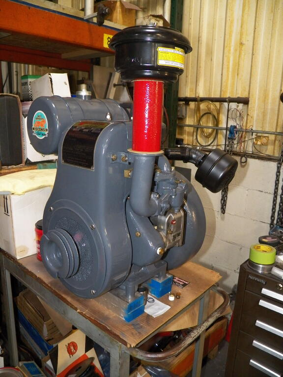

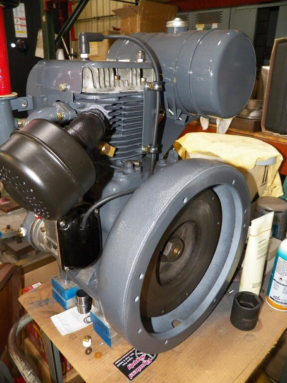

buckrancher 2,697 #175 Posted May 27, 2022 motor rebuild is done 3 10 Share this post Link to post Share on other sites
