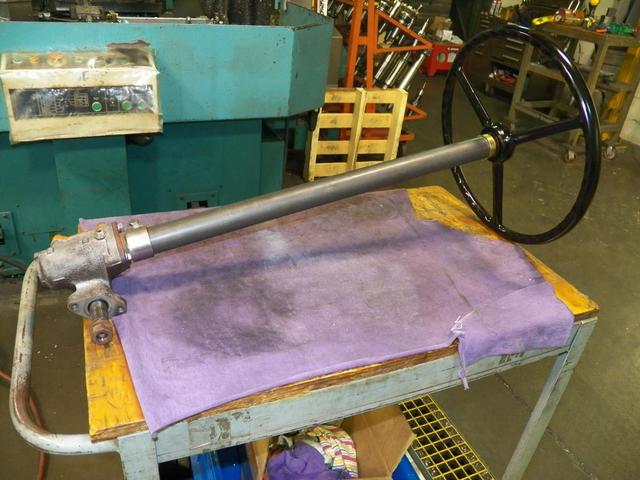

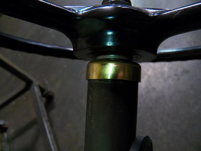

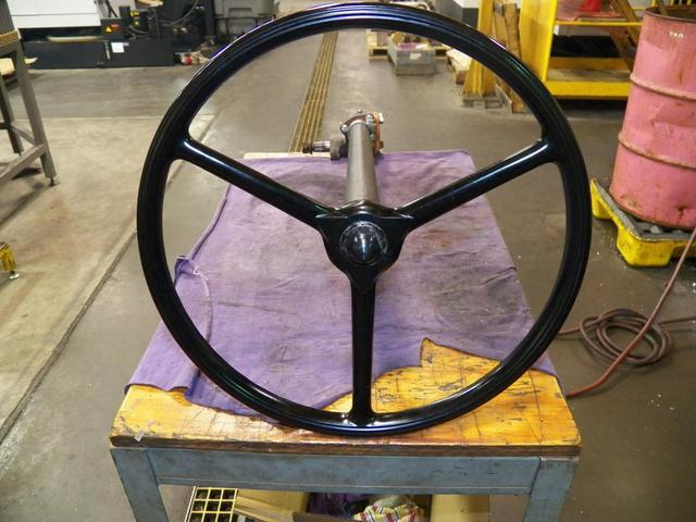

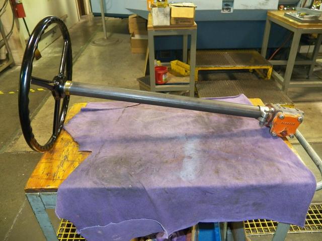

buckrancher 2,697 #80 Posted November 13, 2014 steering wheel on with brass trim piece steering column done other than painting now on to bigger and bent things Brian 10 2 Share this post Link to post Share on other sites

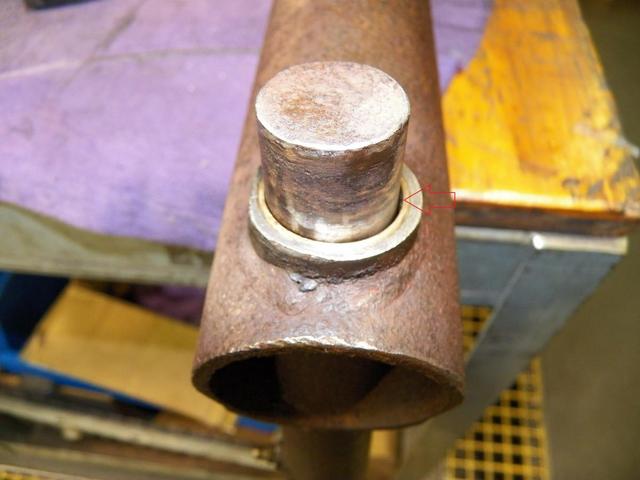

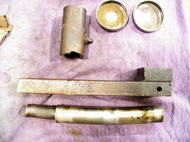

buckrancher 2,697 #87 Posted November 14, 2014 thanks guys finally got the front end apart the other day seems like I beat on it for a month to get it and after seeing the problems I can see why someone must have ran into something very hard I have a lot of bent parts and what ever they hit it was hard enough to break the front axle at the pivot point here is the the axle pivot bushing and whats left of the bolt Brian 1 1 1 Share this post Link to post Share on other sites

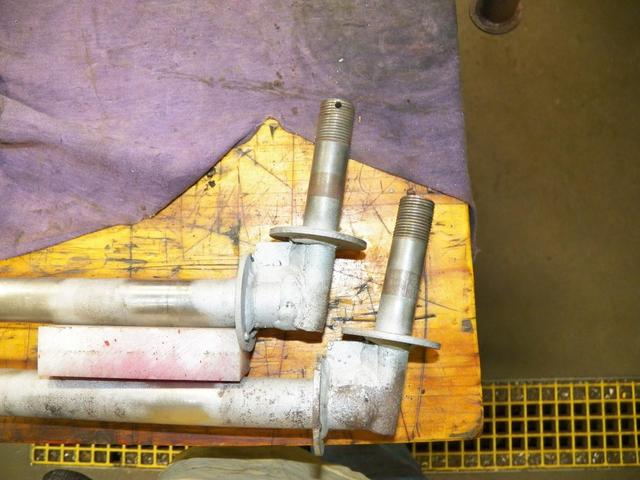

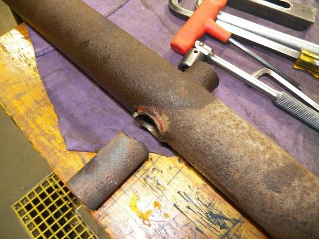

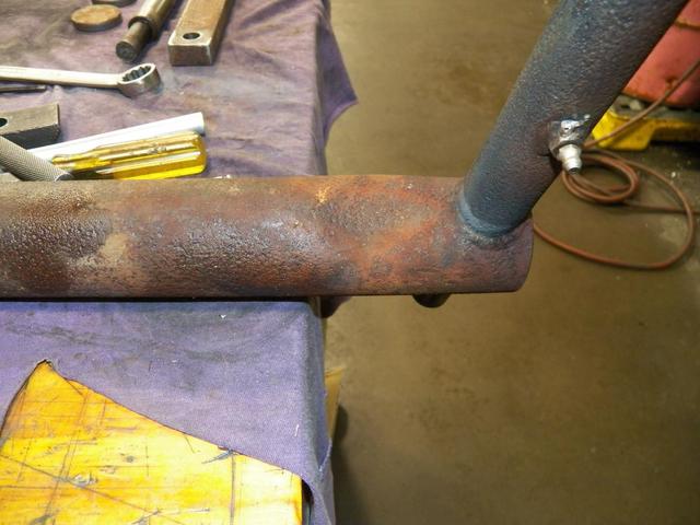

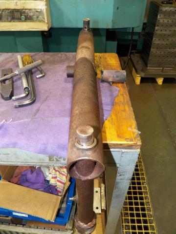

buckrancher 2,697 #92 Posted November 23, 2014 more bent parts you can see the bow in the front axle big dent in bottom of axle lower spindle is bent Brian 1 2 Share this post Link to post Share on other sites
rmaynard 17,540 #93 Posted November 24, 2014 That axle doesn't have a bow in it, that's an early "forward swept" front axle. 2 Share this post Link to post Share on other sites
