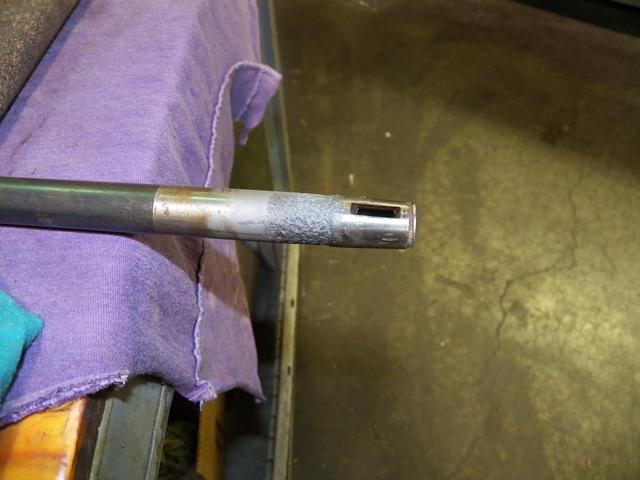

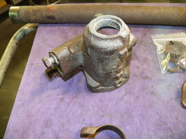

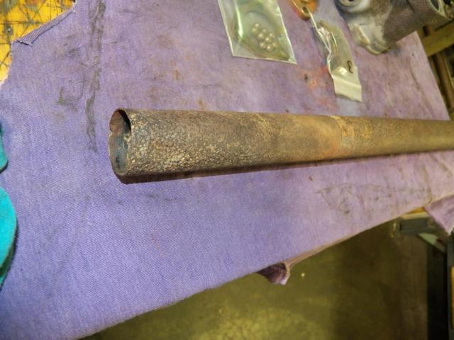

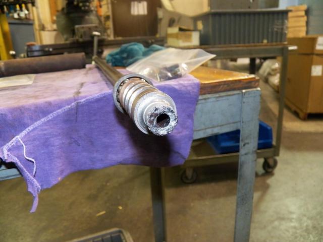

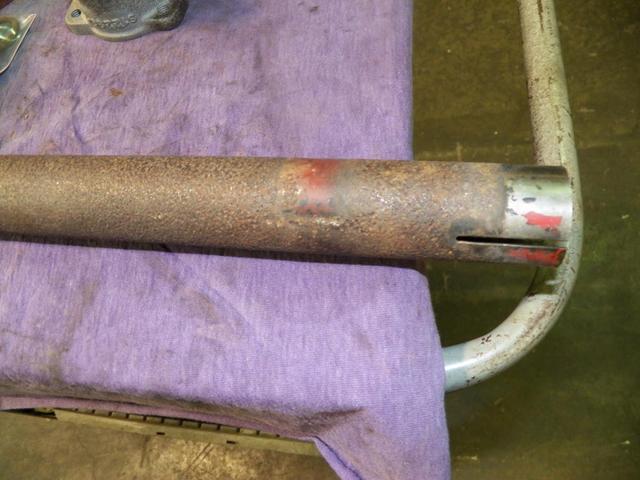

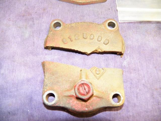

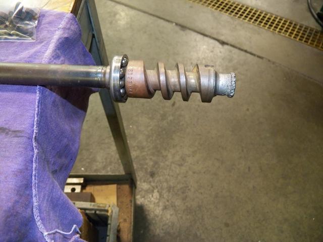

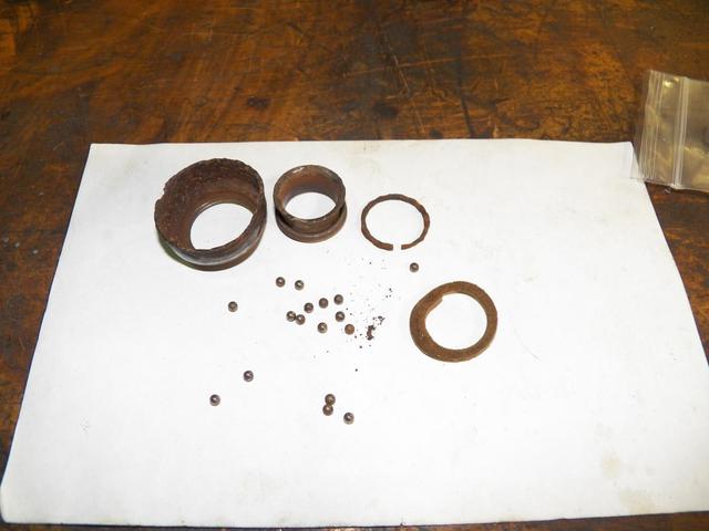

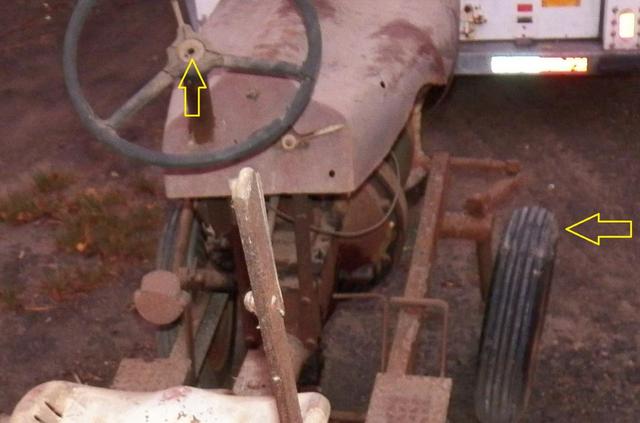

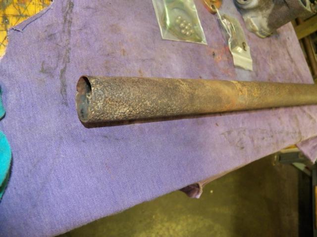

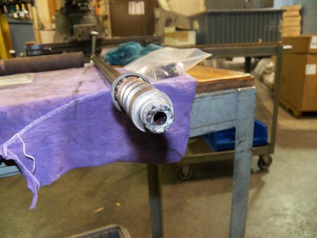

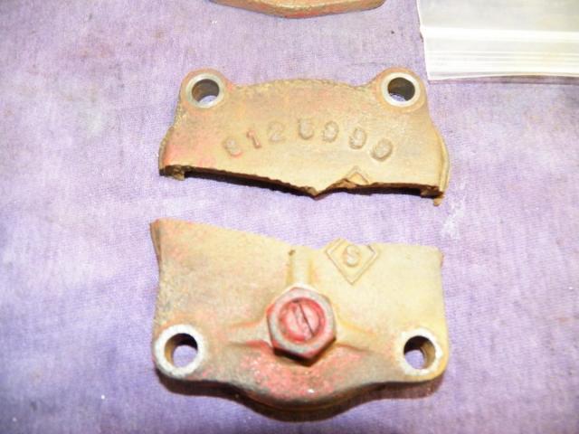

buckrancher 2,697 #39 Posted November 3, 2014 And so it begins.................... I decided to start with the steering as it is very hard to turn the steering wheel and standing in front of the tractor the left front wheel leans out at the top having never spent much time around a senior I was not sure what was missing on top of the steering wheel but a quick pm to my friend Bob (horsefixer) and I had a picture of the top of his senior's steering wheel It took about a week to remove the steering wheel from the shaft so I could get the hood off then I removed the steering column and steering box first thing I noticed was the soft plug in the bottom of the steering box blown out and very rusty also the side cover was cracked It seems someone broke the threads off the steering shaft for the acorn nut that holds the steering wheel on and this let water run down the center of the shaft and in to the steering box the bottom of the box and end of the steering shaft was badly rusted too you can see all the rust pitting this is the upper end where the steering wheel goes This is whats left of the upper steering column bearing and how badly the column is rusted this is the end of the column that clamps to the steering box Brian 3 Share this post Link to post Share on other sites

buckrancher 2,697 #42 Posted November 4, 2014 (edited) Hey Martin I have done alot of sitting back and thinking about this one and countless hours on the internet searching for information in the last two months some of the things I have found out is Ross makes the steering box on the seniors The same box is used on 1949 mighty mite tractors,ottawa tractors and possibly some crosleys you have about the same chance of finding one of these being parted out as a wheel horse senior what I did find is parts from different sources WW2 Willys jeep uses a Ross box different style but a few parts are the same also an Allis Chalmers B tractor both of these use a 1.5 dia. steering column tube the willys steering box output shaft uses the same bushings and seals as the senior and the upper steering column bearing is the same style as the senior but needs too be bushed from 7/8" to 3/4" for the smaller dia. steering shaft in a senior. the allis steering shaft is the same dia. as a senior but is longer and uses the wrong hand pitch in the steering box but the end where the steering wheel goes is the same as a senior. the allis steering box side cover is the same as a senior I have not found a replacement for the senior output shaft yet as the allis is a single pin but larger dia.and the willys is a double pin also the ball bearings ( 5/16" dia) and races are the same in the allis as the senior steering wheel is made by Sheller 15" dia. three spoke with 3/4" tapered shaft with 3/16" key way Brian Brain, Don't even mess with that steering assembly. I have one in better shape you can have. Jeff thanks Jeff Edited November 4, 2014 by buckrancher 2 Share this post Link to post Share on other sites

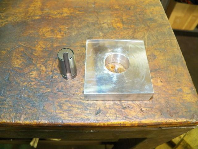

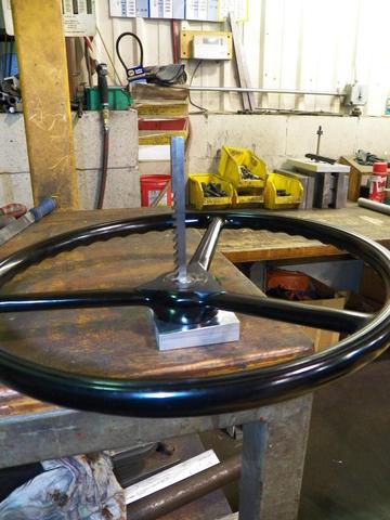

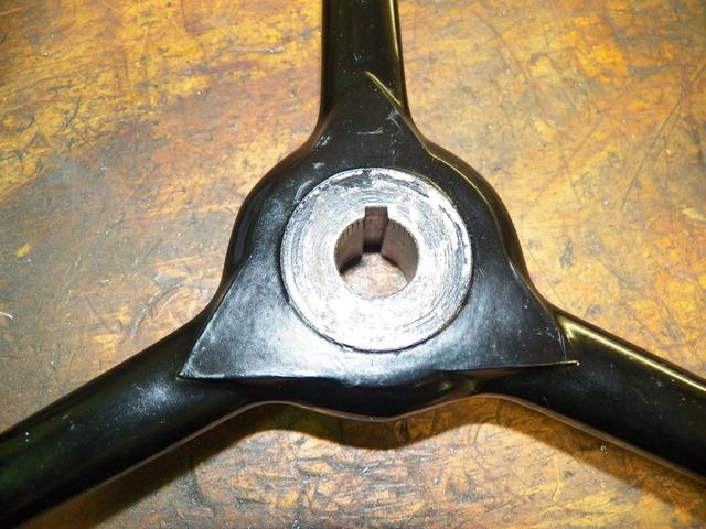

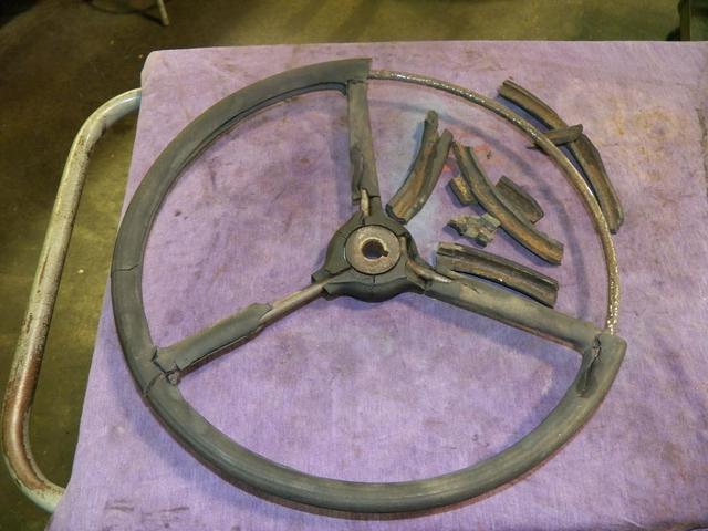

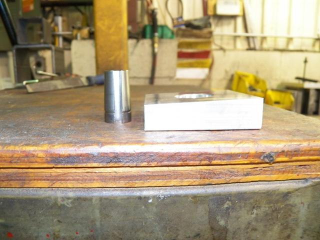

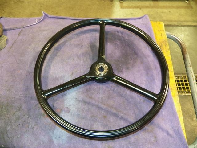

buckrancher 2,697 #50 Posted November 4, 2014 MY STEERING WHEEL IS GARBAGE The original wheel is made by a company called SHELLER after some searching on the net I found one I could use as a replacement also made by sheller with a slight difference the new one is for a 3/4" tapered spline shaft and the original is for a 3/4" tapered key shaft found this NOS military surplus wheel on E-Bay vintage WW2 looks to be a exact match to the original First thing I did was use a tapered 3/4" pipe tap reamer to remove the splines then I made a small fixture and tapered broach guide for a 3/16" broach to cut a new key way the small alum fixture is to hold the wheel at the correct angle so the broach is straight up and down after cutting Brian 11 Share this post Link to post Share on other sites
