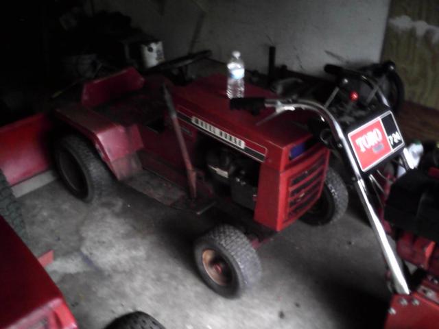

I bought a 69 lawn ranger with vertical engine engine that was in it was from a push mower that's no good.witch engine options do I have that will fit in there.with out cutting anything.my 3 and 7 year old nefuws love this thing I gotta find a motor.and advise helps thanks y'all 🙌

My boy's 67 came with a 6hp horiz tecky that was wore out. I replaced it with a 212cc from  harbor freight, just made brackets for the original tank and made a stack as the exhaust blew right at the hood and would burn the paint off the hood.

I have the real lawn ranger 69-73 mine is a 69 vertical
