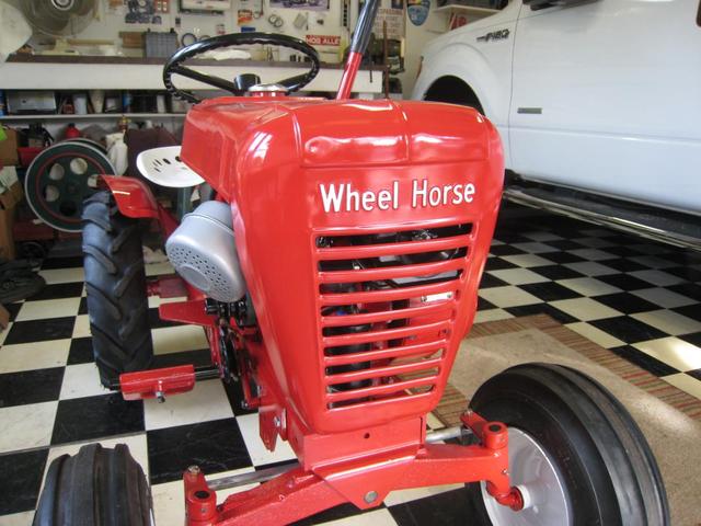

55rj35jr 623 #9 Posted November 1, 2014 (edited) Agree with Bob,, paint marker is the way to go, but like hammerheads idea too.. this is my 701 done with a paint marker Edited November 1, 2014 by 55rj35jr 3 Share this post Link to post Share on other sites
motor12 367 #10 Posted November 1, 2014 After seeing the results of the paint pen that 55rj35jr posted I am going to test both on a scrap piece of metal. I don't want to screw up the real thing. 2 Share this post Link to post Share on other sites

motor12 367 #13 Posted November 2, 2014 I used a paint pen and think it turned out pretty good, thanks everyone 2 Share this post Link to post Share on other sites
55rj35jr 623 #14 Posted November 2, 2014 I used the medium for my hood. medium also I used a paint pen and think it turned out pretty good, thanks everyone nice job,,, looks good... Share this post Link to post Share on other sites
JERSEYHAWG / Glenn 4,499 #15 Posted November 2, 2014 Looks really nice, I ordered the hard rubber roller, I ordered the medium point sharpie paint pen to. Its all I need to do to complete the 854. Good information here. Thanks folks. Glenn 1 Share this post Link to post Share on other sites
Live4outdoors 151 #16 Posted November 2, 2014 Wow, you paint pen guys must have a steady hand...the pics you posted look great, I've seen a lot of hand painted ones rough, haven't got to my project yet but will soon and have to do this same thing. Share this post Link to post Share on other sites
