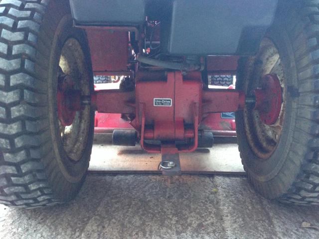

Horse46 519 #53 Posted November 26, 2014 Am i expecting to much thinking that its just a case of the set screw has come loose, and they are going to slide off when I loosen the screw Share this post Link to post Share on other sites
meadowfield 3,191 #54 Posted November 26, 2014 Are you the guy who adds to the wheelhorse register? I did add my details (twice,) didn't notice the message about not automatic up date Yes I have the up to date list, but haven't uploaded yet... Am i expecting to much thinking that its just a case of the set screw has come loose, and they are going to slide off when I loosen the screw If it's recently loose then it might slide back to the right place I've not been that lucky.... Share this post Link to post Share on other sites
Horse46 519 #55 Posted November 27, 2014 Thanks for the pictures, that explains it a lot clearer of what I'm going to find. Finger crossed me thinks. Share this post Link to post Share on other sites
Horse46 519 #56 Posted November 30, 2014 Bit of a mixed bag this weekend, I managed to get myself a mowing deck which is in very good condition. I also moved my hubs all but half an inch from flush, with only a bit of persuasion with a rubber mallet. But all didn't end so well as I think I have fried my starter from over cranking it, while pumping fuel back to the carb after removing the float bowl a few times. What a donk! Share this post Link to post Share on other sites

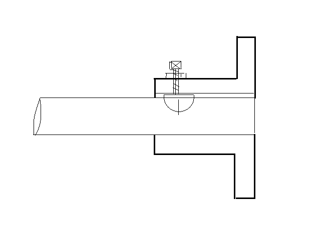

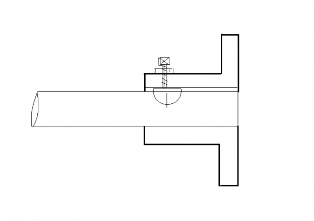

Anglo Traction 761 #60 Posted December 3, 2014 It will be best to move the hubs out flush so that the Lock Screw makes contact with the Key as near to it's centre as possible. If you look at the Pic of the Key/Shaft in Mark's (Meadowfield) post (number #51), you will see the Screw contacts the Key just 'inboard' of the centre of the Key. Here's a rough example drawing of it- If the clearance gap between the top of the Key and the Keyway inside the Hub is too great, the Key can 'Rock' in the 'Half Round' slot milled in the shaft when the screw is tightened and so makes it easier for the whole wheel/hub to loosen when forces move it inwards i.e. turning. Ideally, the Setscrew or Lock Screw should contact the Key exactly in the centre. The Key itself should also have barely any clearance in the Hub Keyway and have a small recess milled in it to take the tapered serrated end of the Screw. Definitely only use a Puller to remove and inspect it. Clean and degrease, then correctly reposition the Hub and tighten the SetScrew and Locknut. Share this post Link to post Share on other sites

Horse46 519 #62 Posted December 4, 2014 Ok i'll have to go borrow a puller, by the look of it from the drawing i'm probably not on the key. Share this post Link to post Share on other sites
Horse46 519 #63 Posted December 8, 2014 I borrowed a puller today, and a big dense hammer and my hubs now sit in the correct position 1 Share this post Link to post Share on other sites

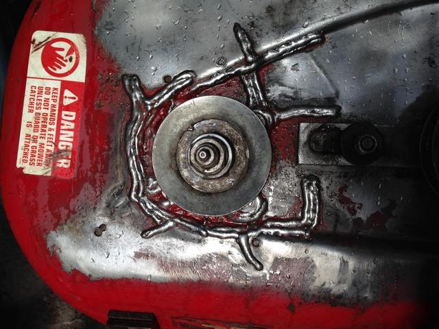

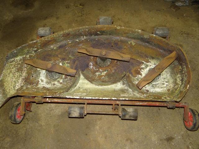

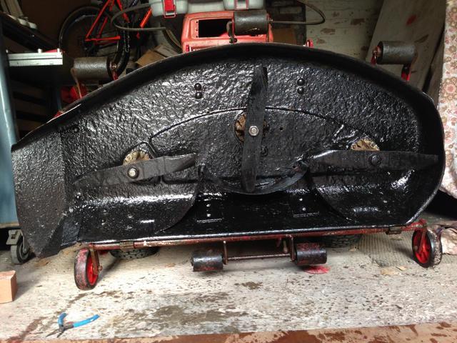

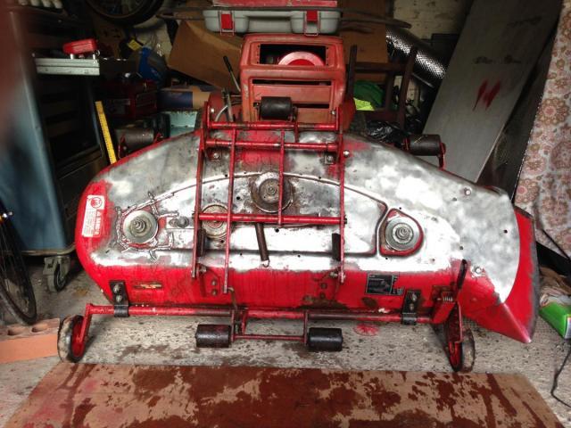

Horse46 519 #67 Posted January 25, 2015 I started to renovate the deck as the weather warmed up a little. I found that the underneath was in pretty rough shape, after a good clean and rust treatment I have given it a thick coat of Hammerite, I hope to get another on before spring for added protection. It has had some previous repairs which I didn't see on first inspection, although they look sturdy enough, and there is no more rot to be concerned about. I got carried away with the wire wheel while doing the top side, so more paint required. I'm going to just hammerite it as it's a working part, not to bothered if it doesn't match the 1 Share this post Link to post Share on other sites
meadowfield 3,191 #68 Posted January 25, 2015 nice welding - looks like it had some serious cracks! Share this post Link to post Share on other sites
Horse46 519 #69 Posted January 26, 2015 nice welding - looks like it had some serious cracks! Yeah, looks like mostly around the crease, which I would imagine would be thinner due to the press stretching the metal? Share this post Link to post Share on other sites
Stigian 1,235 #70 Posted February 7, 2015 As Mark said.. Nice welds I think the cracks around the pulleys are more down to stress than thin metal Share this post Link to post Share on other sites
gwest_ca-(File Mod) 12,533 #71 Posted February 7, 2015 I am a firm believer that the cracks are the result of an unbalanced blade. When I remove a blade I check the balance. If it's off or bent a check of the deck pan at that location usually finds a crack or two. Garry Share this post Link to post Share on other sites
Horse46 519 #72 Posted February 7, 2015 I'll check them all out just in case, they look fairly new and seem sharp enough but that doesn't mean they are balanced does it, good point. Share this post Link to post Share on other sites
Horse46 519 #73 Posted July 2, 2015 I am a firm believer that the cracks are the result of an unbalanced blade. When I remove a blade I check the balance. If it's off or bent a check of the deck pan at that location usually finds a crack or two. Garry Well i didn't take the advise of balancing my blades and now my deck has cracked in another place doh!More welding in my future for sure. Share this post Link to post Share on other sites
