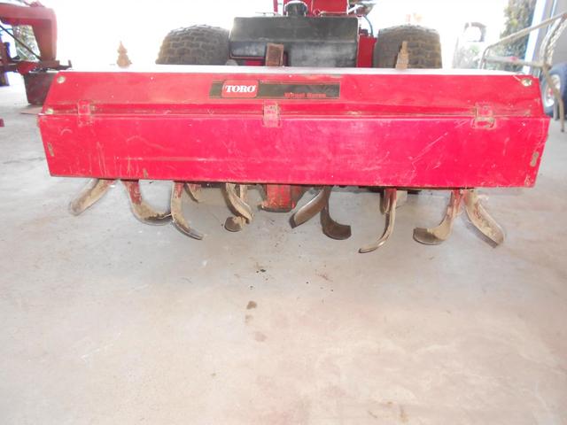

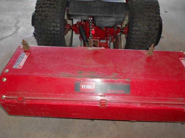

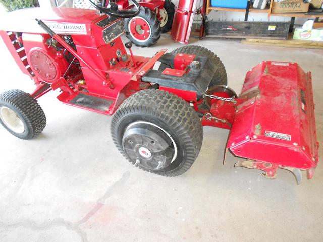

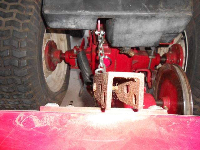

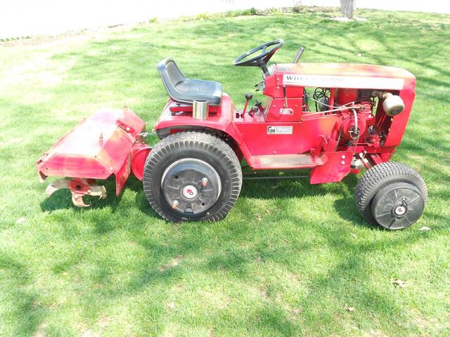

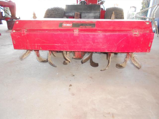

Lane Ranger 12,150 #2 Posted October 28, 2014 (edited) My tiller is only about three inches off the ground when raised by the lift handle. However, when tilling I lower the tiller by moving the chain down one or two links. It takes two to do this sometimes as you have to reset the pin on the rear of the tractor that the chain is held on by. Not much if any slack in chain and maybe one link left loose on top Mike! Maybe some of these pictures will help you. Here is a link to a video of the tiller in action yesterday: IMG_6717.MOV Edited October 28, 2014 by Lane Ranger Share this post Link to post Share on other sites

diamondred 63 #5 Posted October 28, 2014 Depends a lot on which rock shaft you have. I know of at least 3 different ones. Its the story of levers. Or like a teeter-totter, the further out from the fulcrum, the more movement you have. But in this case, seems the more movement you have, the harder it is to lift. One rock shaft has 3 different slots, the lowest one (furthest from pivot point) allows for maximum movement. While the upper slot gives you more leverage for lifting. And the center one, would be the best of both worlds. The chain link adjustments are for larger increments of adjustment, while the cable to trunion threaded adjustment is for "fine" tuning... 1 Share this post Link to post Share on other sites
