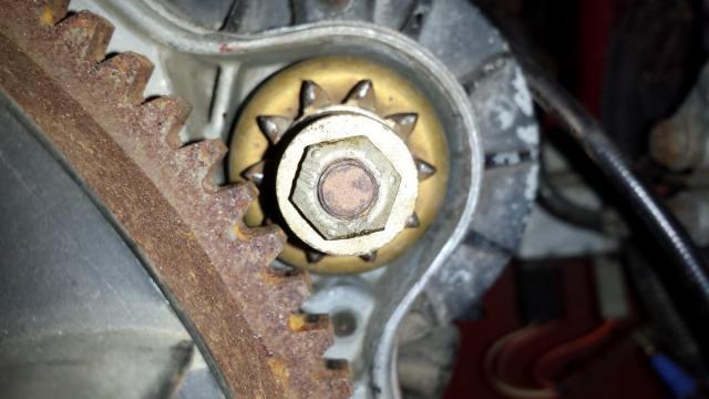

diamondred 63 #1 Posted October 27, 2014 I have a 1989 414-8 with a Kohler Magnum, Seems the starter is only going into the flywheel gear about half way. Starter bolts are tight. Seems loud gear noise as it cranks. I just don't feel the pinion is coming out far enough to engage fully. Pinion is coming out all the way. Was this a problem with these engines? Yeah , I know pictures... I just replaced a pinion on a 8 hp kohler starter, and its as quite as a belt starter Share this post Link to post Share on other sites

diamondred 63 #3 Posted October 27, 2014 The pinion comes all the way out to the nut. But does not go all the way into the flywheel. Will try to post pic tomorrow. Share this post Link to post Share on other sites

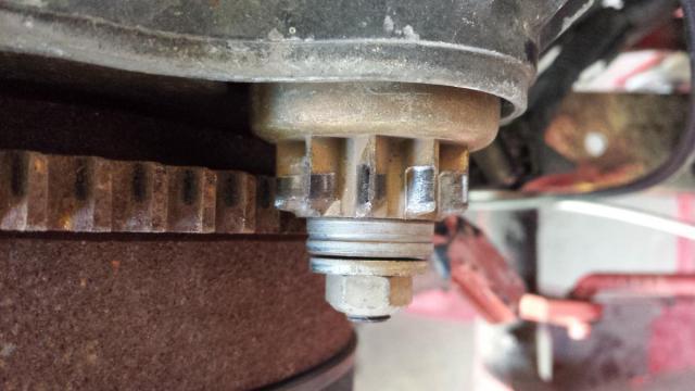

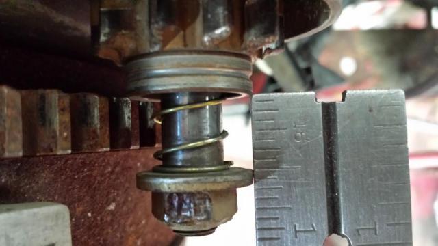

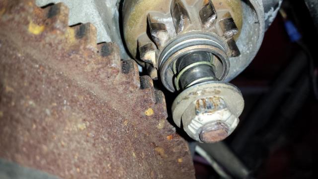

diamondred 63 #4 Posted October 29, 2014 (edited) One picture, thousand words. Its all the way out. Does anyone know if there is shims between the starter and the bearing plate? You can plainly see it is only using half of the flywheel. Edited October 29, 2014 by diamondred Share this post Link to post Share on other sites
km3h 543 #5 Posted October 29, 2014 Take a closer look at the photo. Your flywheel won't allow it to go any further into the teeth. The flywheel teeth are not ground all the way. I think this is about the normal way these things operate. At the top edge of the flywheel the teeth are deeper than they are as you look further down the individual teeth. That is unless the photo is making things look out of proportion. Share this post Link to post Share on other sites
diamondred 63 #6 Posted October 29, 2014 (edited) The pinion is bottomed out against the end of the starter shaft. These are straight cut teeth. ...other than the pinion has a bevel so it can merge into the flywheel at high speed... Edited October 29, 2014 by diamondred Share this post Link to post Share on other sites

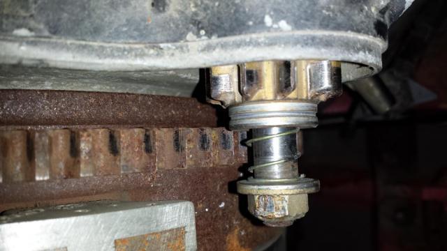

diamondred 63 #8 Posted October 29, 2014 more pictures, I hope these help. Share this post Link to post Share on other sites
oldredrider 2,553 #9 Posted October 29, 2014 It appears you have too many shims on the pinion shaft...blocking a full run of the gear. Share this post Link to post Share on other sites
JustinW.73 224 #10 Posted October 31, 2014 It appears you have too many shims on the pinion shaft...blocking a full run of the gear. Ya I agree. I don't remember them having any washers at the end of the shaft. Try it with them off Share this post Link to post Share on other sites
diamondred 63 #11 Posted October 31, 2014 I didn't put any washers on it. It's stock. Look at the pictures closely. That is not a stack of washers.That is a cupped washer so the spring has some place to go when engaged. Next guess? Share this post Link to post Share on other sites
