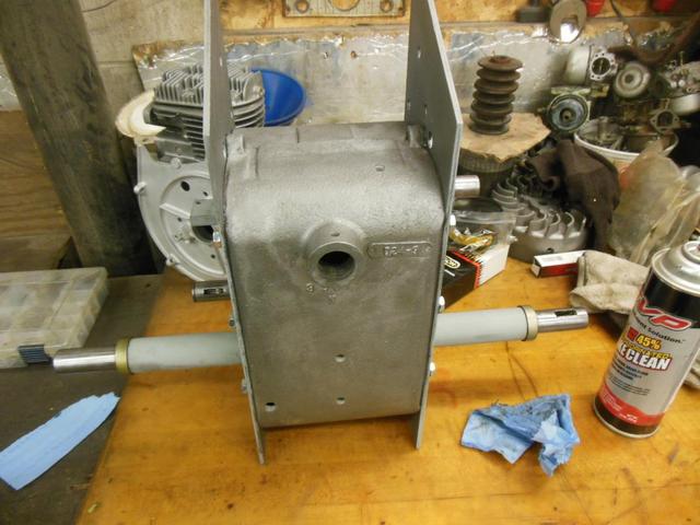

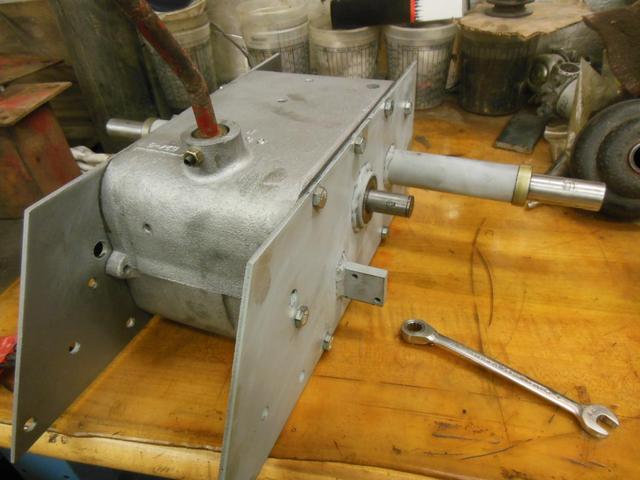

Jake Kuhn 1,600 #33 Posted November 28, 2014 Got some shorter bolts today, and got the trans together today...seems to work fine by hand. 3 Share this post Link to post Share on other sites
dclarke 4,270 #34 Posted November 28, 2014 Lookin good, Jake... Good to know about the short bolts, I've got one to put together. 2 Share this post Link to post Share on other sites
Geno 1,931 #35 Posted November 29, 2014 Looks nice Jake. Thanks for the info on the bolts Steve, I'm gonna try to redo my RJ this Winter and that info will come in handy. 3 Share this post Link to post Share on other sites

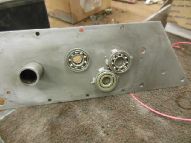

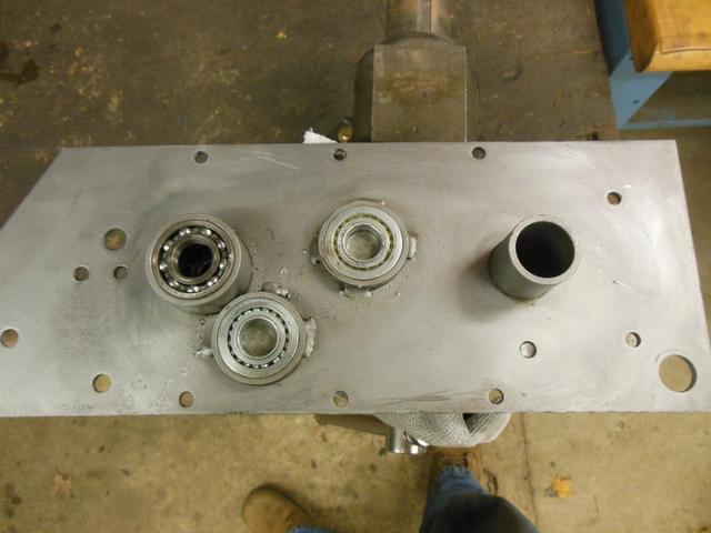

Jake Kuhn 1,600 #41 Posted December 5, 2014 (edited) Ripped it back apart last night, changed the bearings and it doesn't really turn any easier, then did a test fit. It doesn't turn any easier but does feel smoother. Before I silicone it, I just want to check and see if you guys think I put the bearings in the right place this time? Also, am planning to pick up the engine tomorrow from the machine shop, so that may become this weekends project putting it back together. Thanks, Jake Edited December 5, 2014 by Jake Kuhn Share this post Link to post Share on other sites
stevebo-(Moderator) 8,741 #42 Posted December 5, 2014 Jake, Looks right to me but then again I had the same issue you are having after rebuilding a suburban tranny. It is still unresolved... Share this post Link to post Share on other sites
Racinbob 13,047 #43 Posted December 5, 2014 Yup, that looks right to me as well. But now I'm going to scream!! That's the third strike and now my finished 5010 is coming back apart. I'll leave the details for my Suburban thread. :banghead: :banghead: 1 Share this post Link to post Share on other sites

stevasaurus 23,752 #46 Posted December 5, 2014 Jake, your bearings are in the correct places. As for the tightness, unless it is overly tight, I probably would not worry about it...it will break in. Question is...is it tight from being new, or is it tight because something is not right?? Stevbo, I think we talked about this a couple of years ago...about your trans. I did not know why back then, but I have a sneaking suspicion you might have 1 or more of those bearings that measure 7/16" in height in your trans. Share this post Link to post Share on other sites

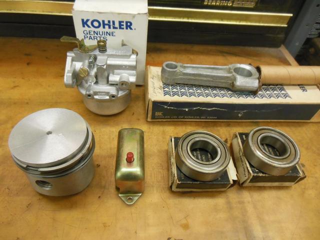

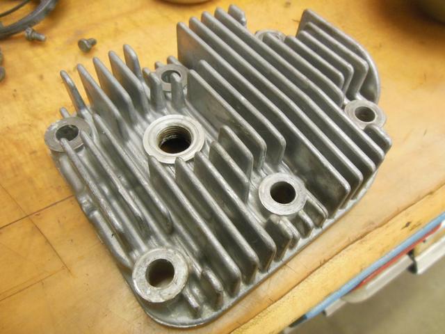

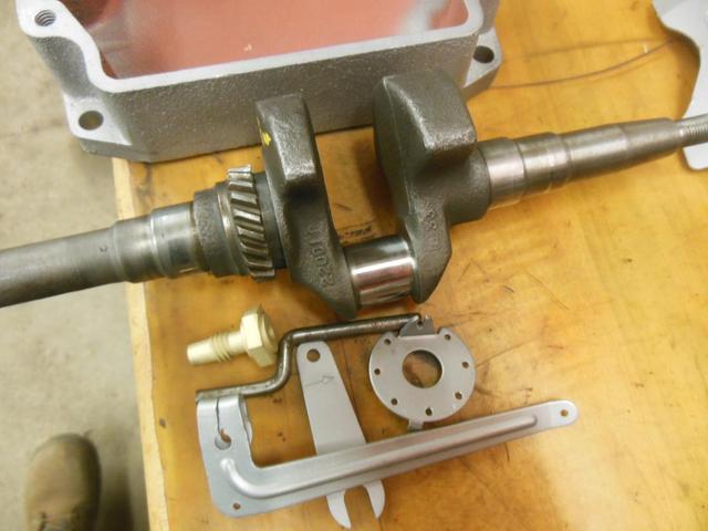

Jake Kuhn 1,600 #47 Posted December 6, 2014 (edited) Picked the engine back up from the shop. It ended up needing the crank turned as well. Cost me a little more than I was hoping to spend on it, but it will be a really good motor now. Also, ended up finding another NOS carburetor for it. I also had a set of crank bearings I bought at PA I didn't plan on using on this engine, but after all that has been done to it I figured it deserved them. Everything is ready to go together now, hope I can put it together tomorrow if I have time. Got this head out a PA too, it is NOS Also about a week ago I recieved a package from a member here, I can't thank them enough! Edited December 6, 2014 by Jake Kuhn 5 Share this post Link to post Share on other sites

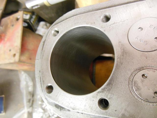

Racinbob 13,047 #50 Posted December 6, 2014 That's looking great Jake. Did you get that crank journal turned down .010"? I'm trying to get that done to mine but everybody I've found prices it like it a V8 crankshaft. I might have a contact that can help me out and I hope to check them out this coming week. I'd be willing to cover the shipping costs if I could find somebody with a price inside of this solar system. Share this post Link to post Share on other sites
