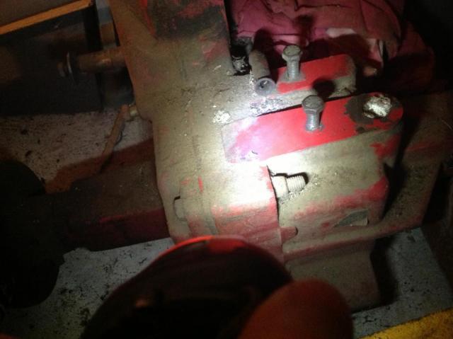

19richie66 17,772 #1 Posted October 23, 2014 I have the 418-A apart for fuel tank repair and noticed when I took the seat stand/tank mount off I could see down in the tranny where the two bolts go. Do you just use teflon tape on the bolts to seal it up when its reassembled or is there a rubber washer of some sort that goes there? Its a easy place for water to get in. Thanks for any info. Share this post Link to post Share on other sites
dennist 139 #2 Posted October 23, 2014 Something does not sound right, but I would not suggest any Teflon tape.... That could get into your pump and then cause you trouble. Any pics of where you can see in the tranny? Share this post Link to post Share on other sites

19richie66 17,772 #4 Posted October 23, 2014 Ill get pics when i get home. May just use an oil drain plug washer below the bolt. Share this post Link to post Share on other sites

19richie66 17,772 #11 Posted October 24, 2014 Yes I have the mount off as you have in the photos. I threaded the bolts back in till I can reassemble it. I think the washers will be my best bet and maybe a LIGHT smearing of silicone. Thanks guys for all the replys. Just making sure I wasnt seeing things. Share this post Link to post Share on other sites
