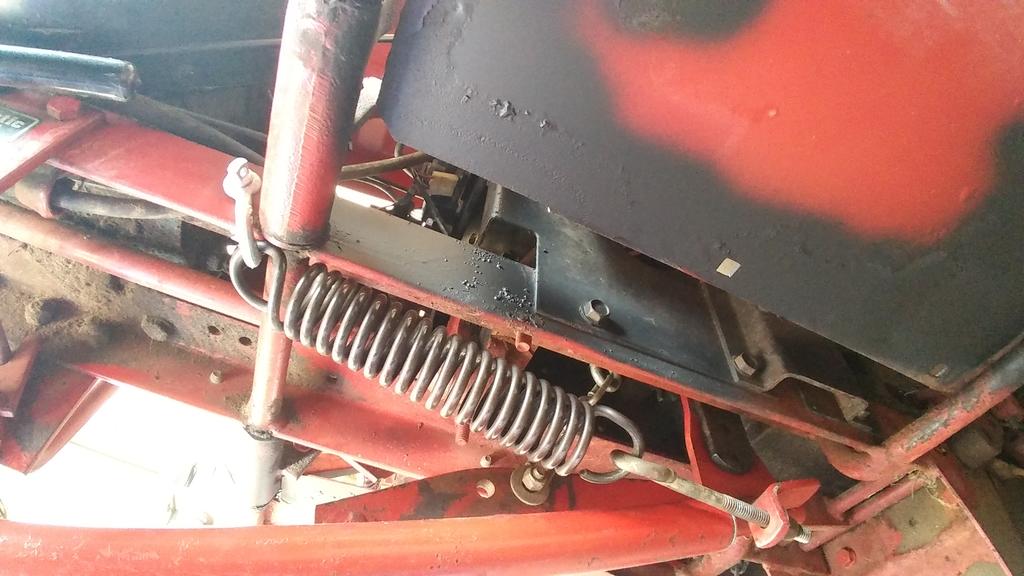

pyroplegic 55 #31 Posted February 15, 2018 This didn't come with a spring and I found a #150 punching bag spring on Amazon for $8. We jacked the blower higher than the lifter bar would lift, Attached the spring to the eye-bolt, that had the nyloc nut backed nearly all the out Attach the bell of a 1/4" shackle through the other end of the spring, and the pin through an existing hole in the frame just in font of the floor board, Tighten nyloc nut to apply tension to the spring Lower jack and enjoy your lighter blower (black is rust-converting primer I-H Red tractor paint is going on tomorrow) 3 Share this post Link to post Share on other sites
