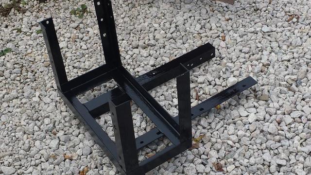

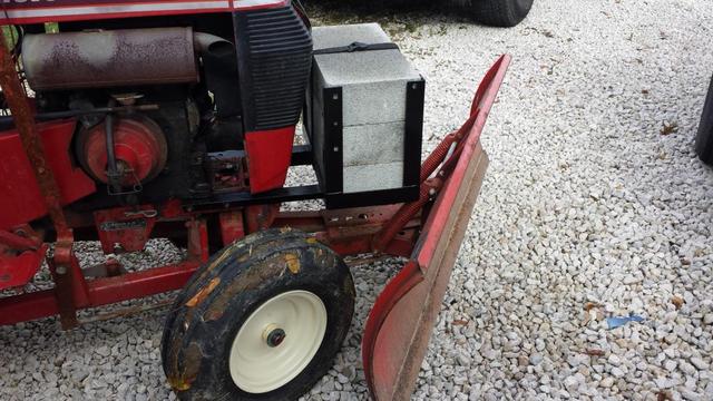

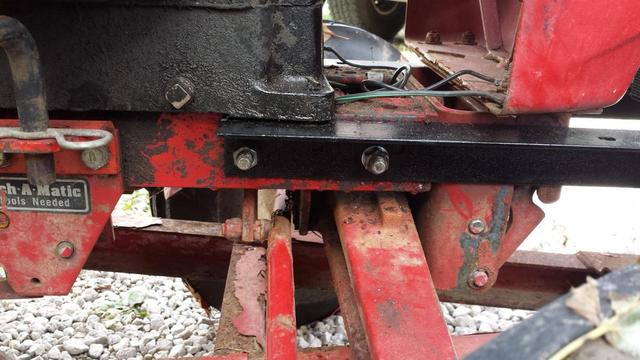

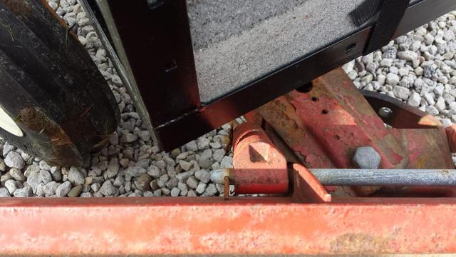

diamondred 63 #1 Posted October 19, 2014 (edited) Seems I had some problems last year with the snow pushing the blade in the opposite direction that I was steering, maybe this will help... Old angle iron from garage door tracks, cut, weld, measure. $1.38 a piece for blocks, 105 lbs. of weight. Still have clearance for blade, but do have to remove 2 blocks to check oil... These will definitely help keep front end down when pulling a Brinly 10" plow as well. Edited October 19, 2014 by diamondred 4 Share this post Link to post Share on other sites

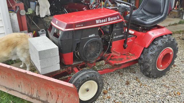

diamondred 63 #7 Posted October 21, 2014 (edited) 55 lbs in each wheel, 325 lbs. in the seat... sure you want to see that rack? Edited October 21, 2014 by diamondred Share this post Link to post Share on other sites
