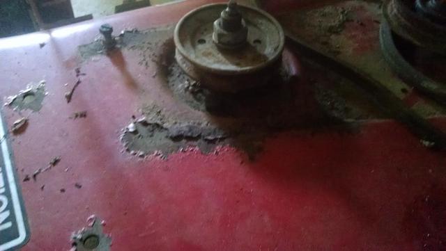

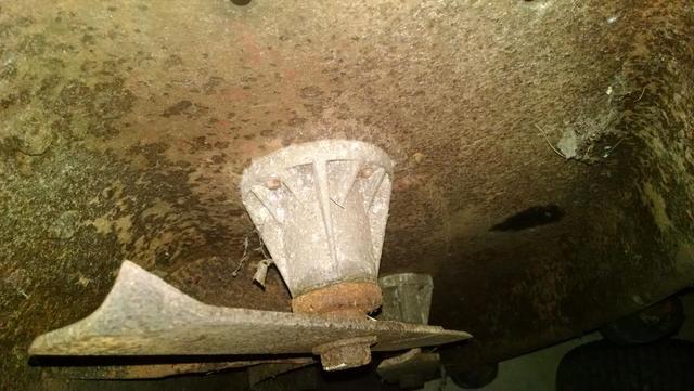

bandit 4 #1 Posted October 15, 2014 I got 211-3 WH mower, the deck has three blades. One of the spindles, pulleys and blade are missing. Was wondering if anyone knew where I can find one or if there's other deck where parts interchange with it. The model and serial numbers have worn off Share this post Link to post Share on other sites

daveoman1966 3,882 #8 Posted October 17, 2014 I have lots and lots of spindles for 36 and bigger size decks. Can you post a pic or 2 of what yours look like...or does it look like on here: Share this post Link to post Share on other sites
bandit 4 #9 Posted October 17, 2014 Hope these help, blades were about 13.75" long? Share this post Link to post Share on other sites
daveoman1966 3,882 #10 Posted October 17, 2014 From the pics, yours is a 42" deck. I have the parts you need. send me a direct email to: daveoman@windstream.net (just clik that email link ) Share this post Link to post Share on other sites
