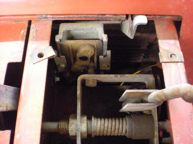

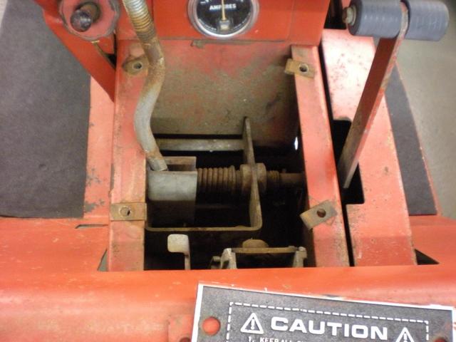

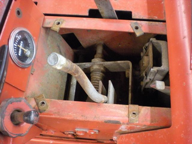

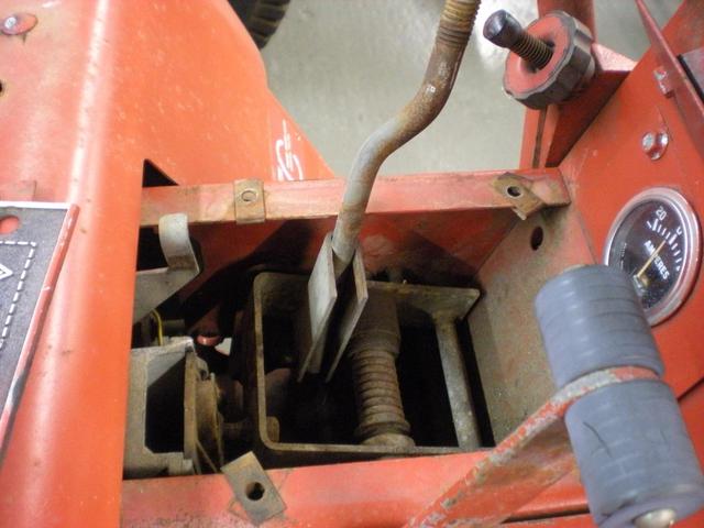

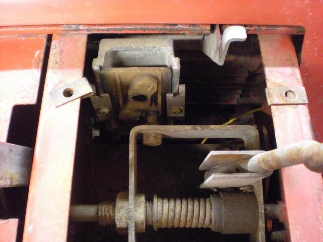

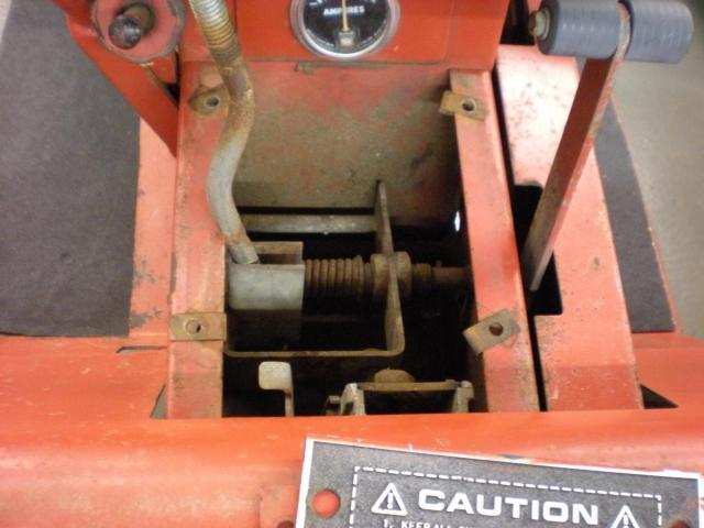

ditchdigger25 3 #1 Posted October 15, 2014 Does anyone have pictures of the shift linkage for a 14 automatic. Mine is apart and I don't know how it goes together. The tractor was taken apart to be painted and I am trying to put it back together there may be a few pieces missing too. If there is some places in this website I haven't found them if someone else has let me know. Thank you Share this post Link to post Share on other sites
Geno 1,931 #2 Posted October 16, 2014 You you have the right side shift handle or center shift handle? Share this post Link to post Share on other sites
ditchdigger25 3 #3 Posted October 16, 2014 Center shifter I need to see the inside and the parking brake linkage just need to get some direction Share this post Link to post Share on other sites
Geno 1,931 #4 Posted October 16, 2014 I haven't seen may center shifts but I have one. Can get you pics in the morn if someone else doesn't do it first. Share this post Link to post Share on other sites
Geno 1,931 #5 Posted October 16, 2014 Are these enough? You can click each one to make it a lot bigger. 1 Share this post Link to post Share on other sites
ditchdigger25 3 #6 Posted October 16, 2014 that is a big help thank you GENO. Share this post Link to post Share on other sites
