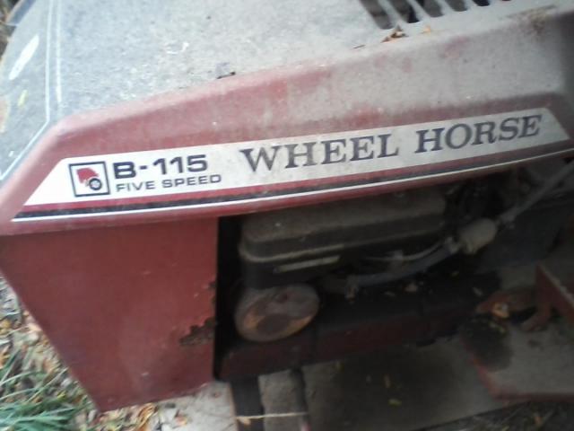

Japple67 3 #4 Posted October 15, 2014 It's an 11hp briggs, plastic fender, ID tag 02-11BP03 then theres a gap followed by 10269. Stamped under that is 0287. still pics later, but cracks in fender, headlights disconnected, 3 flat tires, needs a battery, mesh guard on top of flywheel gone Share this post Link to post Share on other sites

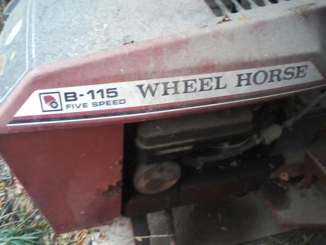

JackC 617 #5 Posted October 15, 2014 Sounds like a vertical shaft model. B=Briggs engine, P= Peerless transmission? 0287 might indicate the unit was made on the 287th day of 1980. It could be a 1981 model? It is a B-115 5-Speed Tractor, 1981 Here is a link to the parts diagrams: http://www.partstree.com/parts/?lc=Toro+Consumer&mn=02-11BP03 Share this post Link to post Share on other sites
bmsgaffer 2,053 #6 Posted October 15, 2014 Looks like you have a B-115 everything we have relating to that model is here: http://www.wheelhorseforum.com/index.php?app=core&module=search&do=search&andor_type=&sid=c584ac347a9f80ac4afae2febde5bb2f&search_app_filters[downloads][searchInKey]=files&search_app_filters[downloads][files][sortKey]=date&search_term=02-11BP03&search_app=downloads&search_app_filters[downloads][searchInKey]=files&search_app_filters[downloads][files][sortKey]=title&search_app_filters[downloads][files][sortDir]= If you scroll down a ways you will find the manuals. Share this post Link to post Share on other sites

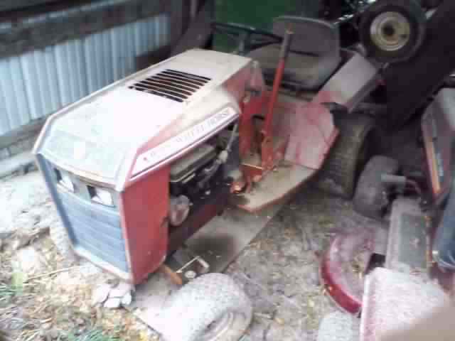

Japple67 3 #7 Posted October 16, 2014 Hadn't had a chance to look at it in a while, but the B-115 hood stickers are still in good shape. To start with I need to make it run again. I'll have to wait on a battery but I have a starter wired for 110v. Last I remember there was a wiring issue, but I don't know what. How do post pictures? Share this post Link to post Share on other sites

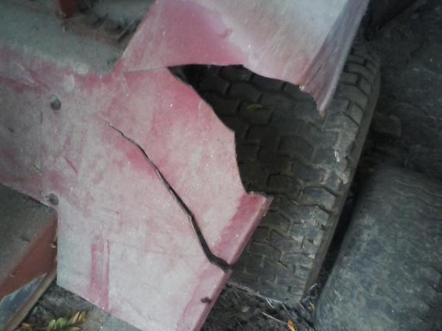

Japple67 3 #9 Posted October 18, 2014 As you can see in the pictures, the original plastic fender is cracked, it is also very brittle. I know there are other model fenders that are steel and will work. What are they and where can I find parts for these tractors? Share this post Link to post Share on other sites

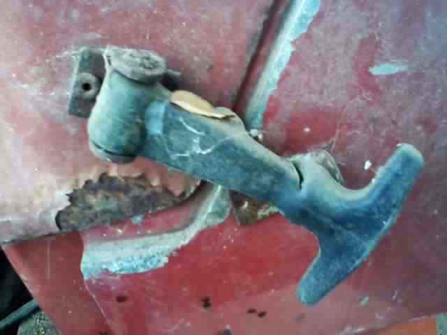

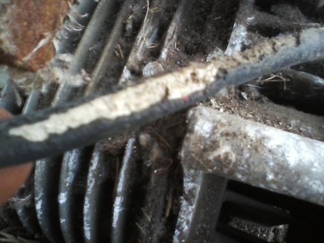

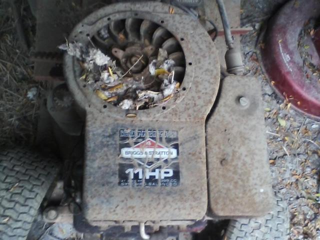

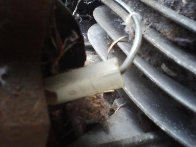

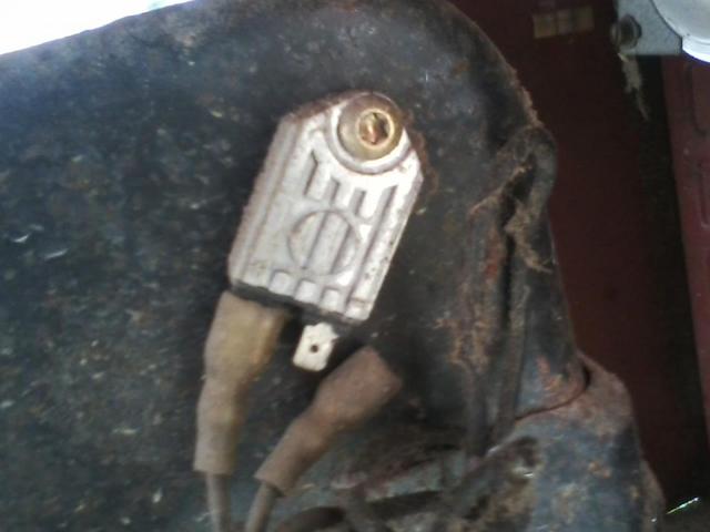

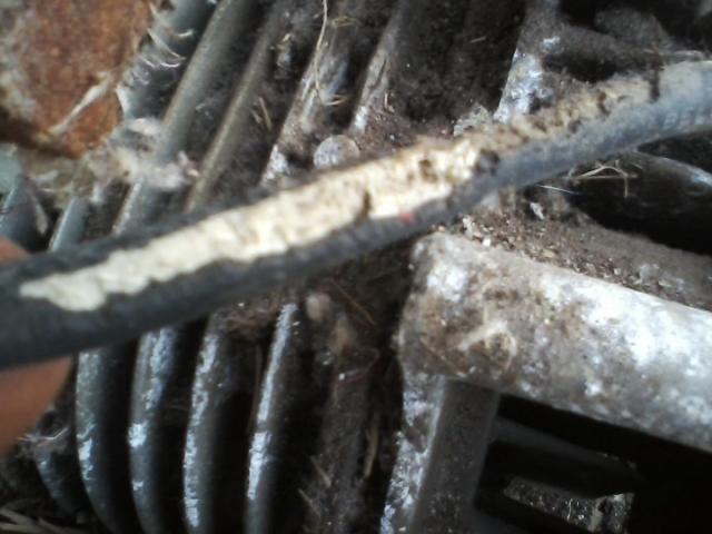

Japple67 3 #10 Posted October 19, 2014 All the engine fins are full of mouse nest and baked on grime, how can i clean the engine up without tearing it down? The mice chewed up the plug wire so any recomendations on where to get one? first picture There is a white wire that is cut off coming from a plug on the armature, what is it? third picture What is the little block on the wire going to the headlights? second picture Where can i get a new air cleaner foam? The hood hold downs are both bad, one completely severed, where can i get them? fourth picture Share this post Link to post Share on other sites
AMC RULES 37,196 #11 Posted October 19, 2014 Ebay is going to be your friend here... finding most of this stuff there. Share this post Link to post Share on other sites
