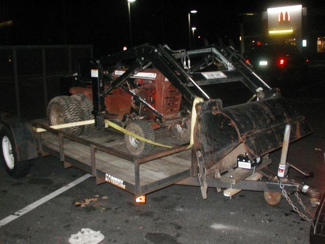

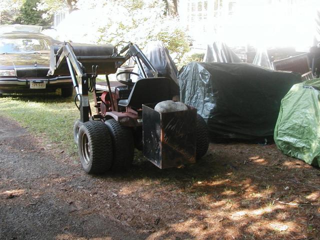

JackC 618 #4 Posted October 16, 2014 I Have an 8 horse power C-81 with a Kwik Way Loader. The 8 horse power is more than enough to power the pump. 2 Share this post Link to post Share on other sites
