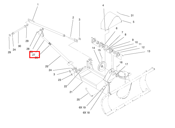

Scotty321 1 #1 Posted October 9, 2014 I just picked up a 2 stage snowblower for a 5XI (Toro 79366 or New Holland 716505006) and it is missing the rod assembly (also called the yoke). Its number 27 in the link below. Looks simple, I'd like to fabricate one instead of spending $150 on it. Anyone willing to take some measurements? Thanks in advance. http://www.torodealer.com/en-us/Pages/parts.aspx?Model=79366&Serial=200000001&MYBEID=22437&PageId=349076&IllustrationId=336617&CallOut=27#27 Share this post Link to post Share on other sites

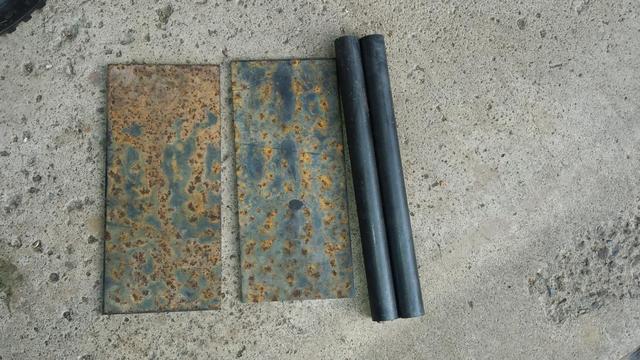

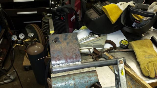

Scotty321 1 #6 Posted October 15, 2014 Here is the progress so far, will probably finish it up this weekend. Rick, Thanks for the great sketch. Share this post Link to post Share on other sites

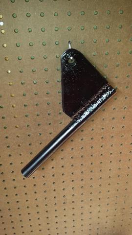

Scotty321 1 #7 Posted October 27, 2014 Here's the finished product. Haven't been able to try it out yet. The deck is such a bear to take off, I will probably wait until I am done mowing for the year before mounting the snowblower. 1 Share this post Link to post Share on other sites

Rick_in_CT 156 #9 Posted October 27, 2014 Scotty, Nice job, it looks like the real deal. rick Share this post Link to post Share on other sites
