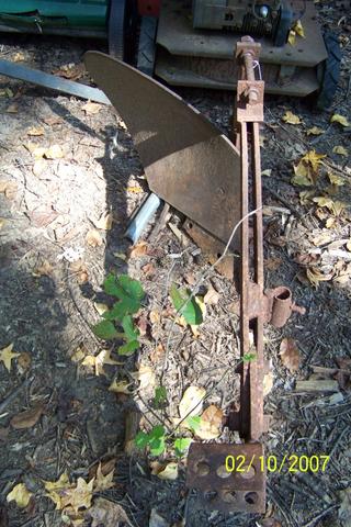

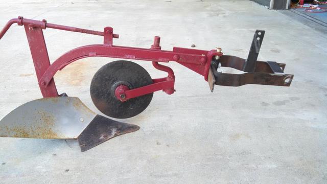

ibskot 37 #1 Posted October 9, 2014 I have one that has a single hole. I have not tried it. I was thinking about getting one that I could expect to have more control. There is another one on CL that is like this. The holes but they are offset. Should I use what I have or try to upgrade? Thoughts? Share this post Link to post Share on other sites

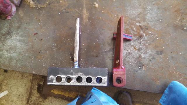

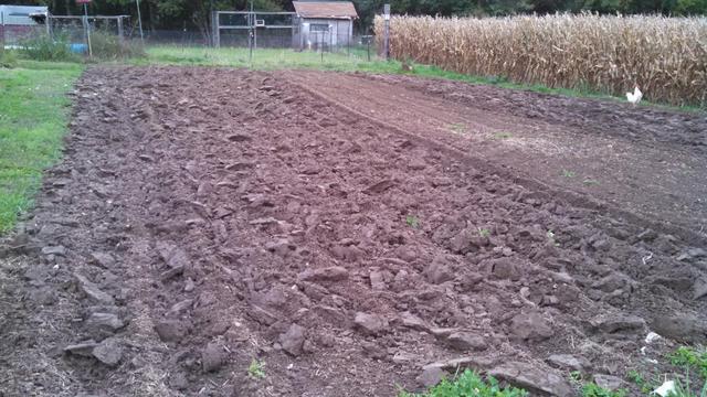

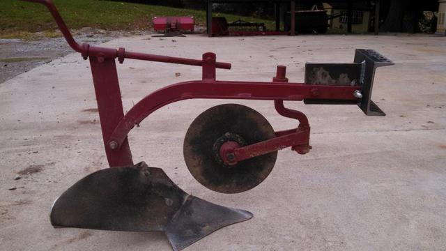

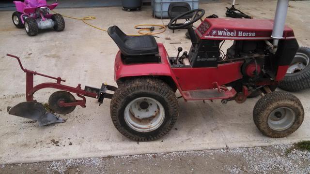

rollingflat 123 #2 Posted October 9, 2014 I have been plowing w a 8" plow w only one slot hole for two days now and it is working great. had it for a while but did not have a slot hitch until I made one last weekend. Worked great. It is leaving a small " land " between furrows but am going to make a three hole slot end to replace the single one, should take care of the gap problem. Share this post Link to post Share on other sites

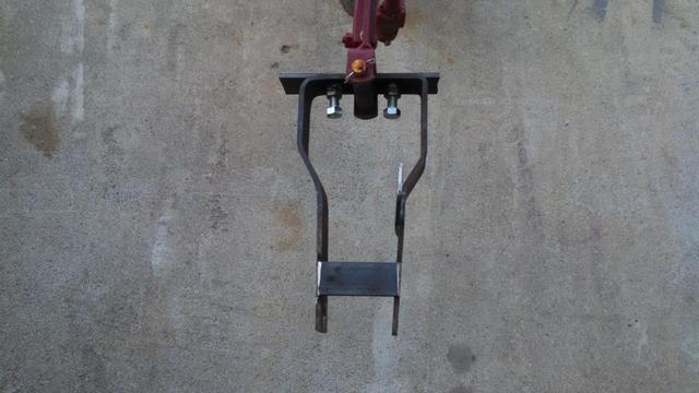

ibskot 37 #3 Posted October 9, 2014 I thought about doing this. Does it stay straight when you left it? Share this post Link to post Share on other sites
squonk 45,055 #4 Posted October 9, 2014 Plowing with a slot hitch and a single hole WH plow. Share this post Link to post Share on other sites
Catmanii 36 #5 Posted October 9, 2014 I thought about doing this. Does it stay straight when you left it? Yes it will stay straight (The one in the picture) when lifted, you just need the clevis hitch that Rollingflat is showing you. Works great. Not sure exactly what you have with a single hole, but long as the plow is not to big it can most likely be modified if needed. I try not to buy anything different untill I run out of ideas on how to modify what I already have. Share this post Link to post Share on other sites

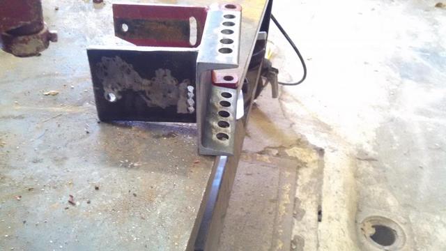

rollingflat 123 #6 Posted October 10, 2014 posted the modified hitch in wrong post so I'll try again. Share this post Link to post Share on other sites

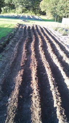

rollingflat 123 #7 Posted October 10, 2014 (edited) Part of garden started weds, had to stop b/c flat. have not tested new hitch b/c of rain. Edited October 10, 2014 by rollingflat Share this post Link to post Share on other sites

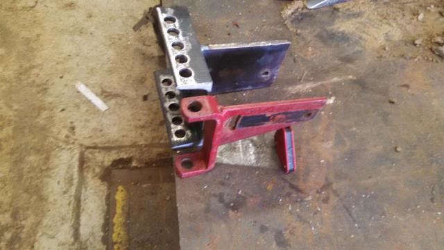

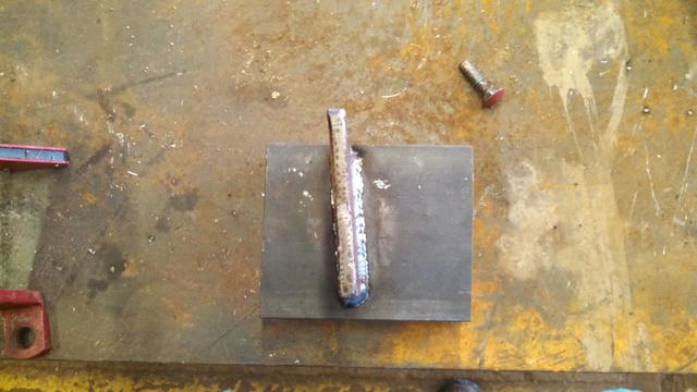

rollingflat 123 #9 Posted October 10, 2014 the parts I used is: 6" length of 5" c channel. 5.5" length of 4" flat iron. Welded at slight angle to match old one. Share this post Link to post Share on other sites

rollingflat 123 #11 Posted October 10, 2014 I would try the one hole plow before upgrading... it will probably work fine. Does it look similar to mine? Share this post Link to post Share on other sites
rollingflat 123 #12 Posted October 10, 2014 If you dont have a welder you can get the sleeve hitch on e-bay Share this post Link to post Share on other sites
ibskot 37 #13 Posted October 10, 2014 It looks like your....doesn't shine like yours. Ebay, never thought of that. Share this post Link to post Share on other sites
rollingflat 123 #14 Posted October 10, 2014 The pic of the partly plowed garden was taken weds. before i made the modified hitch. the plow worked great as you can see just wanted to have more ajustment. But have not tested mod. today b/c of rain all day. Share this post Link to post Share on other sites
