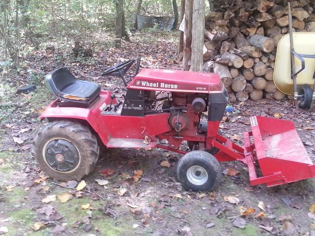

ibskot 37 #6 Posted October 8, 2014 I wish it was a real front loader...actually this helps a lot when driving through woods. Helps make a path. 1 Share this post Link to post Share on other sites
Geno 1,932 #7 Posted October 8, 2014 I like it. Where did you get it? Share this post Link to post Share on other sites
ibskot 37 #8 Posted October 9, 2014 From a forum member. Bill in Va. Don't remember his forum name or his last name. Nice guy though. Share this post Link to post Share on other sites
