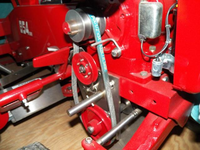

redsquarebob 27 #1 Posted October 7, 2014 sickle mower pullys dont line up with motor any ideas? Share this post Link to post Share on other sites
KyBlue 655 #2 Posted October 8, 2014 have a picture? Share this post Link to post Share on other sites
scotty 252 #3 Posted October 8, 2014 Kinda hard to get a picture but should give a general idea. Share this post Link to post Share on other sites
Trouty56 568 #4 Posted October 8, 2014 Sure you have it mounted in the correct bolt holes....looks forward a bit...what tractor is this??? Sent from where I am....... Share this post Link to post Share on other sites
scotty 252 #5 Posted October 8, 2014 this is on an 855 maybe its not compatible with this tractor Share this post Link to post Share on other sites
Trouty56 568 #6 Posted October 8, 2014 I don't know....is that the problem?? Too far forward? Or is it too far out/in???? Sent from where I am....... Share this post Link to post Share on other sites

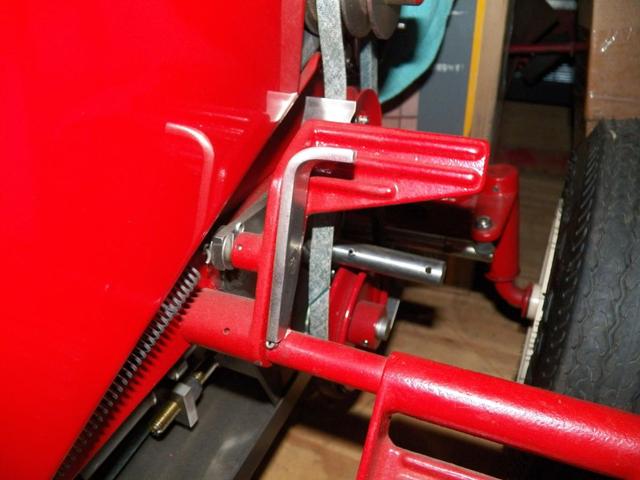

buckrancher 2,697 #7 Posted October 8, 2014 The first picture does not look right the pedal with the pulley should be up against the side plate not out at the end of the shaft Brian Share this post Link to post Share on other sites
scotty 252 #8 Posted October 8, 2014 the pullys are out to far on the sickle mower so they wont line up with the sickle mower. there arnt any other holes the bolts will go in. these things suck to hook up. how do you get the pully pushed in and the big pully on the bottom is not in far enough either is there some adjustments? Share this post Link to post Share on other sites
buckrancher 2,697 #9 Posted October 8, 2014 there should be another hole in the shaft for a pin by the foot pedal The large pulley should be adjustable by sliding it on the shaft after you loosen some set screws Brian 1 Share this post Link to post Share on other sites
scotty 252 #10 Posted October 8, 2014 (edited) thanks very much now that makes more sense i was getting frustrated haha. also do you know what size belt goes on the clutch pully. that goes around the big pully and motor. Edited October 8, 2014 by scotty Share this post Link to post Share on other sites

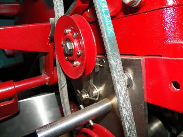

Trouty56 568 #11 Posted October 8, 2014 Are you talking about the idler pulley?? It looks to me you are missing a spacer......from the tractor....The idler...then a spacer....then the belt stabilizer.... Sent from where I am....... Share this post Link to post Share on other sites
Trouty56 568 #12 Posted October 8, 2014 Good...you got it.... Sent from where I am....... Share this post Link to post Share on other sites
buckrancher 2,697 #13 Posted October 8, 2014 I know what the problem is you have a front mount for a newer tractor like a raider that has floor boards not the old early sixties stirrups for your feet Share this post Link to post Share on other sites
scotty 252 #14 Posted October 8, 2014 im gonna have to try adjusting the pullys and see if i can make it work. the mower hangs off the right side. Share this post Link to post Share on other sites
Trouty56 568 #15 Posted October 8, 2014 I dont know brian.....i put this on a charger....i dont think it would have mattered....... Sent from where I am....... Share this post Link to post Share on other sites
buckrancher 2,697 #16 Posted October 8, 2014 you need to weld a 1/2" pin in the hole on the side plate and get one of the old style power take off pedals look at the pics I built the stainless steel one so you could put it on pretty much anything you can see the shaft your pedal is on and I am not using it for the 854 tractor I have this on I have the old setup with the pedal and link bar Brian Share this post Link to post Share on other sites
