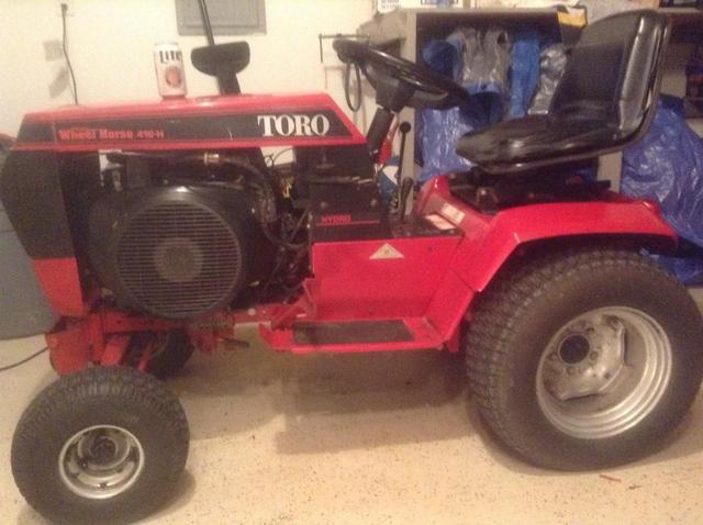

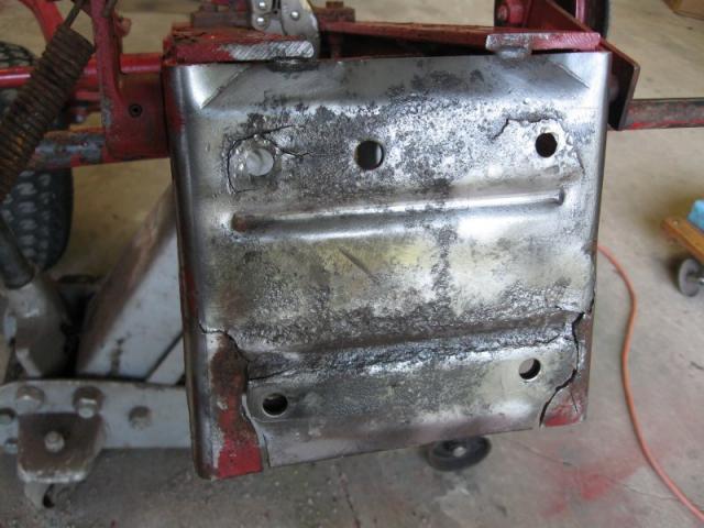

thehorse 221 #1 Posted October 7, 2014 Well after a long drive , I got the 416-h home. Model 41160E01. It appears to have some frankenwiring done to ir, but seems everything works. 671hrs. But after running around the yard for 30 min or so....the hr meter didn't seem to move. Next time I buy a machine with a "working" meter, I'll let it run till it moves to make sure. All in all though it runs strong and hydro all works well. Will need some new tires and some seat work as well as welding.the transmission mount is cracked pretty good. Has some inner wheel weights on it....never saw those before. Once it's all taken care of though it should make a fine worker. I plan on running a blower on IT this winter..Does anyone have Napa numbers for the engine and transmission filters? Will a weld suffice on the mount or should I also look to plate it? Share this post Link to post Share on other sites

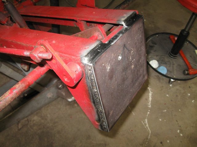

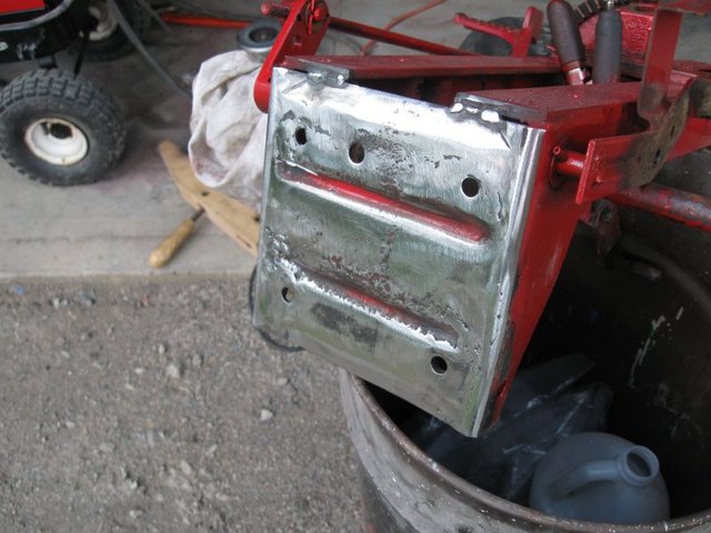

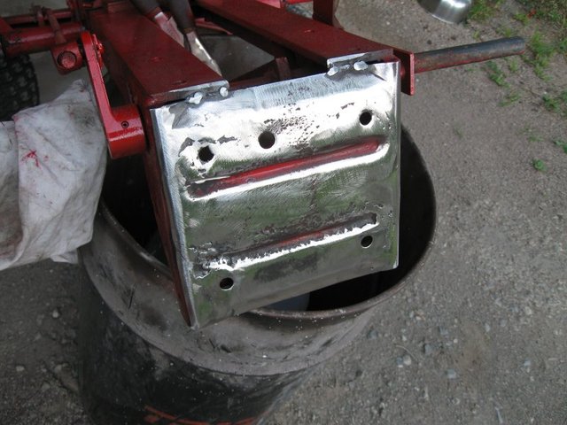

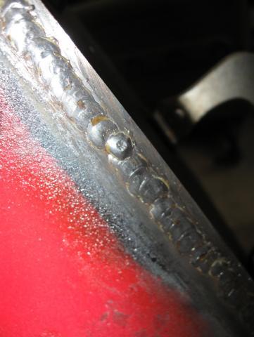

woodchuckfarmer 333 #3 Posted October 7, 2014 I welded 1/4x1 bars across the holes, top and bottom. Welded the cracks on the trans side and ground it smooth. Wayne Share this post Link to post Share on other sites

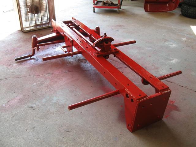

PaulC 342 #4 Posted October 7, 2014 Hey Len my 312-H had the same issue. I don't think it will effect anything unless you plan to put a load on the rear axle. I never knew mine was like that until I made a beefy trailer hitch that mounted to the axle and tried to move my snowmobile trailer loaded with sleds. Anyway here is a thread I started of how I fixed mine quite strong now!!! Share this post Link to post Share on other sites

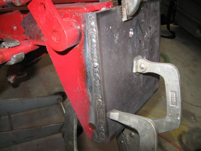

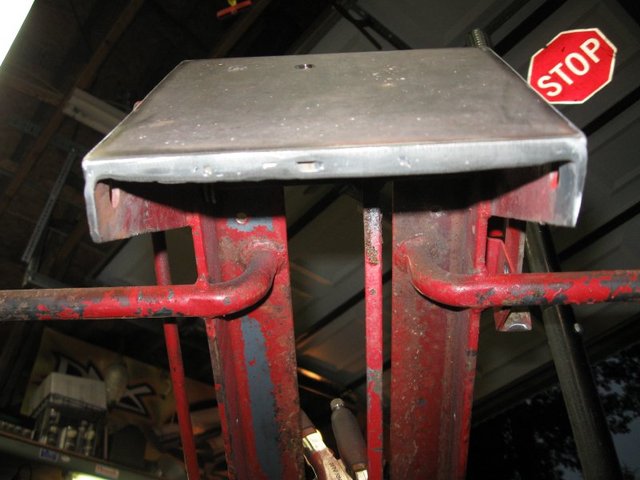

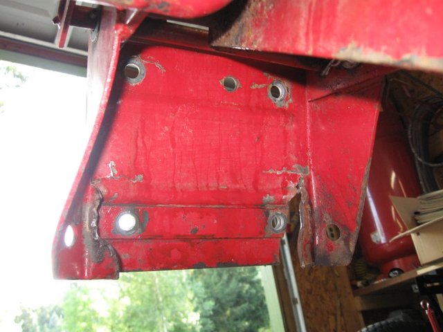

daveoman1966 3,884 #8 Posted October 7, 2014 (edited) This is how I fixed my 520-H and an older C-120. PO had tried to weld a 1/4" plate to the frame plate but it was destined to fail. So, I cut and shaped these two 1/4" 2x2 angle iron braces / reinforcements. It is now BULLET-PROOF. For those without welder skills (or access to), this is a very doable alternative, no weld needed. Inasmuch as the strain is largely transferred to the side plates instead of the 4 frame bolts and plat welds, this would seem a much stronger repair. I use all Nylok nuts on the 3/8 bolts. Note the fulcrum point of the last pic, which 'pinches' the cracked frame plate to the trans case while you work on it. The trans case sits on the wood block on the concrete block.... Edited October 7, 2014 by daveoman1966 Share this post Link to post Share on other sites

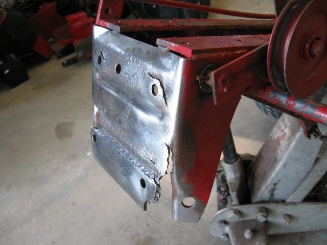

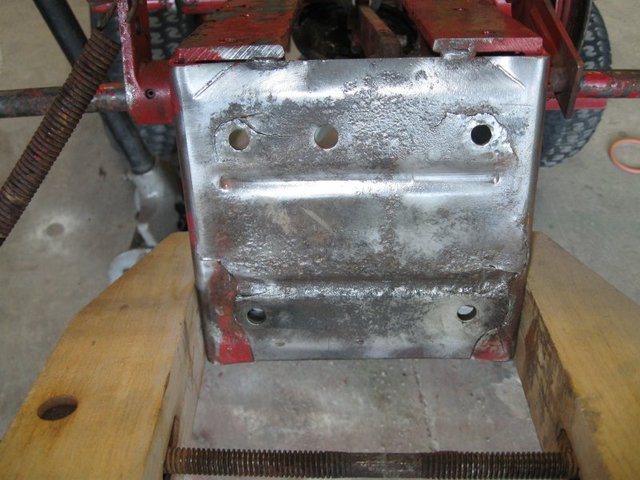

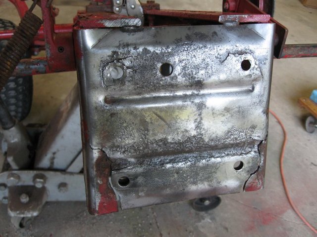

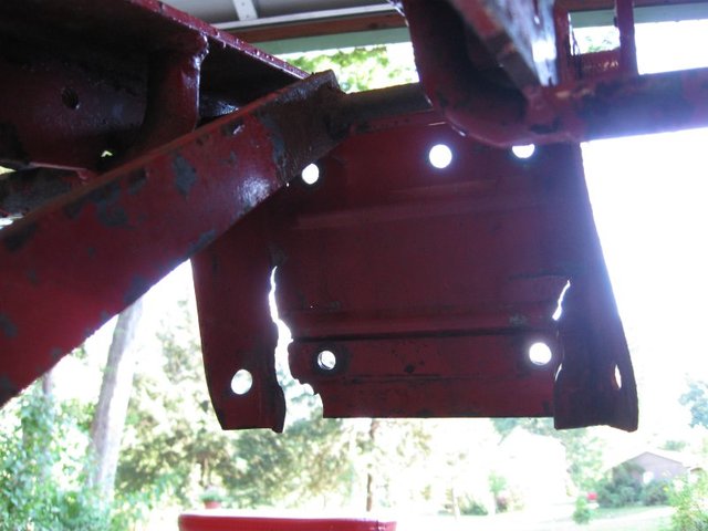

daveoman1966 3,884 #11 Posted October 7, 2014 I wish I'd have kept (or pics of) some of these from years past. Typically, the crack starts at either lower bolt, then progresses to the bottom edge of the plate. When this goes unnoticed, over the years the crack will migrate to the corners of the plate and split it toward the top...giving rise to a full-length corner crack, in addition to cracks around the mounting bolts. You can see this corner crack in the last pic....where it is split just at the level of the two bolts I installed. In any case, the angle iron plates I made reinforce both the corners and the face of the end plate. It should be noted to use 4 mounting bolts that are longer ONLY by the thiclness of the repair plate (and washer) being used. Using a bolt that is too long MAY, on tightening, bottom-out and break the trans case itself....not sure. Share this post Link to post Share on other sites

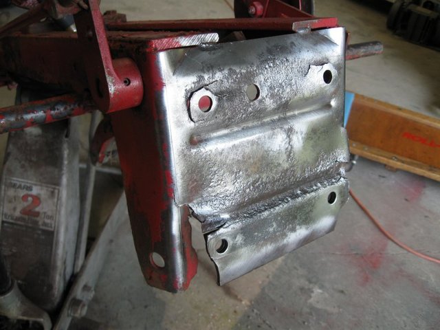

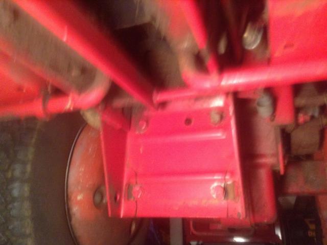

N3PUY 1,031 #13 Posted October 7, 2014 (edited) This is how I repaired my 416-8. Edited October 8, 2014 by N3PUY Share this post Link to post Share on other sites
chipwitch 73 #14 Posted October 7, 2014 I am not a welder and really dont have access to much in the line of materials. Whats my best option? I dont plan on towing anything with the tractor. Your original post, you asked if welding the crack would be sufficient... I assumed you had access to welding? Welding is far and again the best. You don't have to be a pro. Heck, just a ocy/acet set up can do an excellent job welding and is quite easy. I guess there are more than one ways to skin a cat, as they say. Daveoman's solution doesn't require a welder and would really help. If you're using a blower, I don't think you'd have much stress to worry about. Just weld the cracks and keep an eye on them. If you have a sheet metal shop in your area, you could give them plans and they could brake you a 3/16" doubler that would spoon right into the original mount. Add a couple bolts like Daveo's and you'd have a great non-weld repair. You could probably find a small welding shop that would probably only charge you $20 bucks or so if you took the part to their shop with the doublers already cut to dimension and prepped. Just sand off all paint, rust and scale using any kind of sander and 80 grit Share this post Link to post Share on other sites
PaulC 342 #15 Posted October 7, 2014 If you have no intentions of towing anything substantial I would keep an eye on it and leave it be. I did not know about this design flaw and used my tractor that way for a while until I tried to tow my sled trailer loaded up. Pulling my lawn sweeper and empty sled trailer quite a few times before I never had an issue. If you really want to fix it (I may be biased ) but I think my bracket is the best option. The others are great options that would hold up just fine but I think the way mine carries the load up another foot or so on the frame acting as a gusset would be the strongest. If I made one up for you all you would need is you standard tools and a hand drill and 2 drill bits. If you decided you want to do that I could ship this bracket and the motion control plate we talked about in your other thread at the same time. Share this post Link to post Share on other sites

PaulC 342 #24 Posted October 7, 2014 Scroll up on this thread and check the photos that N3PUY posted his is by far the worst id ever seen and it had the extra strip, my 312-H had the strip and cracked as well. I have another 312-A that I don't think ive ever checked but am going to soon. Maybe it does only happen from torqueing stress on the rear axle from heavy attachments and such. I am a former fabricator that is now doing mechanical design and I think I would have confidence in that design if it were new to me. To bad I don't have a 3d model of our awesome tractor frames maybe I could run some analysis on it with the fancy new programs we have today and see if that would show as a weak point. No clue about those holes but there were 22 some odd attachments made for these beasts maybe one of those would use them? Share this post Link to post Share on other sites
