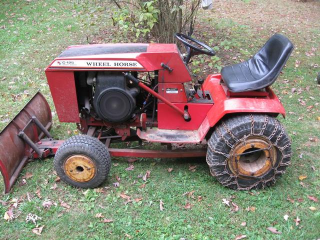

N3PUY 1,031 #20 Posted October 5, 2014 Here's my C-125 with fenders from a 310-8 that met it's fate in a shed fire. I just can't keep my tire chains shiny! That's a mixing cup over the cracked fuel cap. 1 Share this post Link to post Share on other sites

chipwitch 73 #23 Posted October 5, 2014 N3PUY... that doesn't look too big AT ALL! Looks nice. The that gas cap mod is a well... a gas! lol Someday, maybe mine will look that good. Still a long way to go. Share this post Link to post Share on other sites
