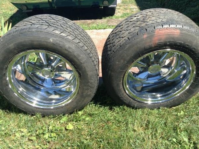

cruisnblue48 880 #31 Posted November 12, 2015 Candy red would look cool, one day that's how I want to build one and with pearl white rims.... To now with my new exhaust it has a muffler but I want to put a chrome straight pipe on it. What are you doing for rear rims? I just bought this set of 14" Cragar wheels off of the local C-list dirt cheap. They have a 4" backspace. So, I am planning on using these wheels with 2" wide adapters to set the wheels out some and still be able to use the tool box and fenders. Share this post Link to post Share on other sites
953 nut 68,882 #32 Posted November 12, 2015 These slicks would be just right on those Cragars!http://www.summitracing.com/search/tire-size/26-x-8-50-14?SortBy=BestKeywordMatch&SortOrder=Ascending&keyword=mickey thompson slicks 1 Share this post Link to post Share on other sites
cruisnblue48 880 #33 Posted November 12, 2015 (edited) I think I'll see if I can burn the rubber off these tires before I invest in a pair of $400 slicks. Edited November 12, 2015 by cruisnblue48 1 Share this post Link to post Share on other sites
