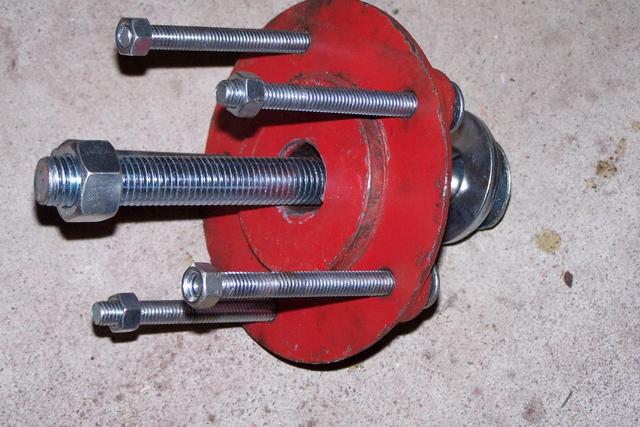

bmsgaffer 2,053 #2 Posted October 1, 2014 You have to be careful with hammering. The axles are held in the differential with clips and if you hammer it you could pop one of the clips and then require a full tear down. If your puller has a pointed end on it (like mine) i used a 1/4-20 nut to spread the force out without mushrooming the axle. I put it under a lot of pressure after soaking in PB blaster and tapped the hub itself with a hammer. After just working on it slowly (just a small turn) for a while it broke free. However, many people using the jaw pullers break the cast hub because its on there so tight. If you look around people have made pullers with other WH hubs to spread the force out even more. Search the forums for "hub puller." There are many different ideas. 1 Share this post Link to post Share on other sites

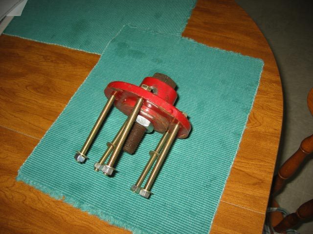

Lane Ranger 11,511 #4 Posted October 1, 2014 Yep just like Paul -it use another HUB and bolts and nuts to slowly remove the stubborn hub. The woodruff key is usually flattened where the set screw comes down on it and makes the hub much harder to remove . I did this several times after trying the other methods ! 1 Share this post Link to post Share on other sites
wake49 18 #5 Posted October 1, 2014 What do you do, tighten down all the nuts (in the lug positions) to force out the axle? Share this post Link to post Share on other sites
Lane Ranger 11,511 #6 Posted October 1, 2014 Yep -you position the hub with bolts on the other HUB still on the transmission. You set the center bolt against the axle . You tighten up all the bolts so all six are firm and then you slowly tighten each of the five outer bolts on the outer hub until the inner hub (hub still on axle and transmission) starts to move and then comes off! Share this post Link to post Share on other sites
jrc0528 20 #7 Posted October 1, 2014 Just a note, you'll do well to use grade 5 or 8 bolts for the 5 outside bolts. I didn't and ended up badly deforming the threads on all 5 bolts, my hub was extremely tight!!! Share this post Link to post Share on other sites

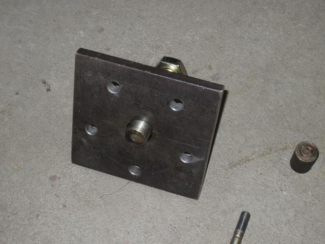

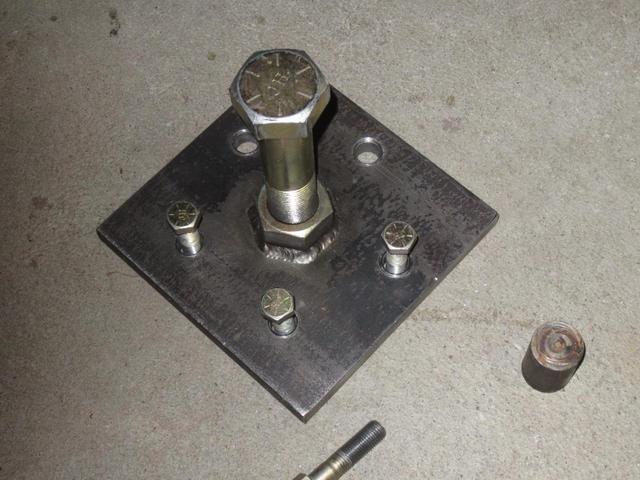

doc724 925 #11 Posted October 1, 2014 Here is the hub puller I had built (since I do not have welding or machining skills). It is super heavy duty and I have not found any hub that will not succumb. It is made from 1/2 inch steel plate with a 1" grade 8 nut welded to it and uses a 1" fine pitch grade 8 bolt to apply the load to the axle shaft. Bolt the plate up to the offending hub with five 7/16-20 bolts, put a 1 1/2 open end wrench on the welded nut. (These wrenches are long enough so that it will touch the floor and provide the resistive force to the torque you will apply to the bolt). Drop a 1 1/2 inch, 3/4 sq drive socket onto bolt and crank away. Because the threads on the bolt are not long enough to completely remove the hub, halfway through the removal process, I have to remove the puller and insert a 1 inch diameter cylinder into the partially removed hub and reassemble the puller. If I had to do this all over again, I would use a 7/8 diameter bolt so it could be used on 1 inch axles. How well does it work? I have pulled 3 sets of hubs. Two sets were real nasty and one was relatively easy. An impact wrench would have speeded up the task. The puller that an earlier RS member made from a hub will work as well, I just did not have a spare hub lying around. 2 Share this post Link to post Share on other sites

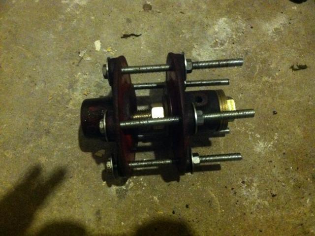

wake49 18 #15 Posted October 2, 2014 Okay, I picked up the bolts I need. Unfortunately we only sell partial threads in the larger bolts here, so I had to make due with a 3/4" x 5" with a few washers. It has an 1-1/2" stub on it. I hope getting it started is enough to safely use a puller, but if not I will back it out and add a spacer. When you tighten the bolts where the lugs are, do you use a star-shaped pattern or go in a clockwise pattern? Share this post Link to post Share on other sites
pfrederi 18,785 #16 Posted October 2, 2014 I must admit I use a clockwise pattern...star would probably be better (I would lose my place trying a star pattern ). Key is to do it slowly After things are snug only 1/2-3/4 turn on a bolt before i go on to the next one Share this post Link to post Share on other sites
wake49 18 #17 Posted October 4, 2014 I actually got it to break free with the "hub to remove a hub" trick! It took about forty five minutes of tightening downs bolts, but it came free. Now I start cleaning and priming! 3 Share this post Link to post Share on other sites
