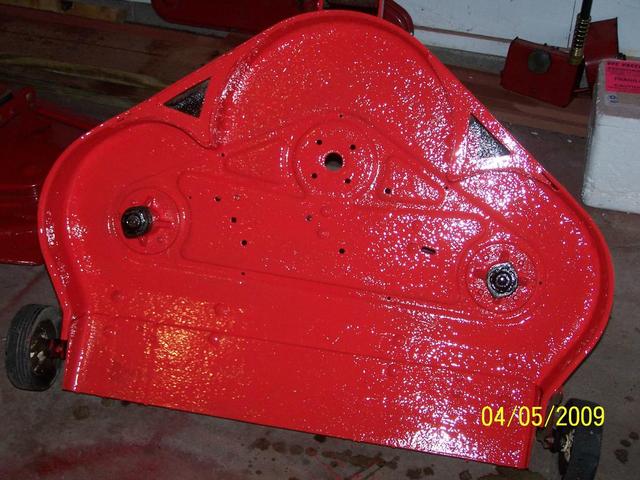

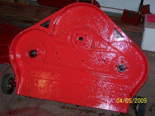

slammer302 2,157 #1 Posted October 1, 2014 I've seen the topic come up a couple times about using spray on bed liner for under a deck so I thought i would share my experience with it here's a few pics of my deck off my lawn ranger that I used this summer for mowing that I used spray on bed liner. I will say the only place that is flaking off is were I welded in a stainless steel patch when I restored the deck I'm not disappointed in how it held up its about what I expected I think using POR15 or easy slide graphite coating would be the better route but this is cheap and was worth a try hope this helps someone out 1 Share this post Link to post Share on other sites

GlenPettit 1,718 #3 Posted October 1, 2014 (edited) I think that most of the "Spray Bed Liners" have a rough-softer surface (to keep things from sliding around in the bed of a truck). On the underside of your deck, you want a very smooth-hard surface so the moist clippings slide off easily and don't stick. POR15 alone is excellent, hard and very smooth. I like to also use "Slip Plate" (liquid Graphite) on the underside, and then redo the graphite every year. IMO, the Bed Liner may not be the better choice if it is rough-soft, unless the actual surface itself resists grass sticking (like a silicone coating would). Edited October 1, 2014 by GlenPettit 3 Share this post Link to post Share on other sites

slammer302 2,157 #6 Posted October 1, 2014 I did this before I new about por 15 like a week before I found out about it and as you can see the grass does stick to it but I don't see any rust 1 Share this post Link to post Share on other sites

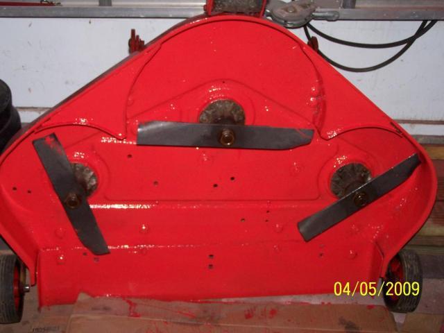

slammer302 2,157 #11 Posted November 2, 2014 Here's a pic of my commando 8 deck I used the ez slide graphite coating nothing really stuck to the bottom but the coating is long gone in sum spots and I only had a few hours of mowing on it sense I cleaned and put the coating on so if you don't mind recoating a few times a year I would say it works well Pic Share this post Link to post Share on other sites
