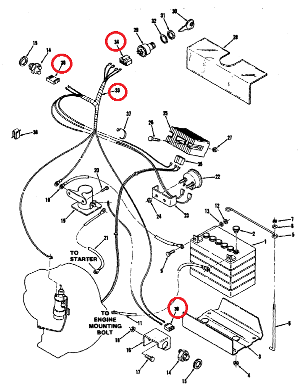

rmaynard 16,858 #3 Posted October 1, 2014 I have one new old stock #106051 wiring harness left for a 1977 B-80, B-100, C-120, C-160. It includes all items circled in red. PM me if interested. Share this post Link to post Share on other sites

rmaynard 16,858 #5 Posted October 1, 2014 Yep, that's a different harness. There isn't a universal wiring harness that will fit every C-120. But having said that, it's pretty simple to make one. Just a few feet of 14 or 16 gauge wire in several colors, some readily available 1/4" spade terminals terminals and ring terminals, a wire crimper, and a couple of connector housings, some electrical tape, and you can make your own. I know there are a few threads here on the forum where others have shown how they made their own. 1 Share this post Link to post Share on other sites
