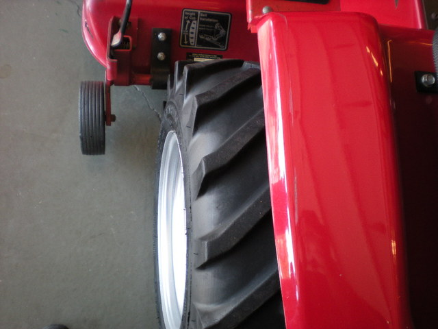

Geno 1,930 #59 Posted October 2, 2014 I sent this to Nick already but for those of you who want to see a Carlisle 23-850-12 on a 414 rim here it is, I just put these on dads old tractor. The Carlisle is truer to spec. 1 Share this post Link to post Share on other sites
Martin 2,133 #60 Posted October 2, 2014 (edited) thats great Geno. gives an idea of how the newer Carlisle ags look on the standard rim. they are the tru powers correct? Edited October 2, 2014 by Martin Share this post Link to post Share on other sites
bmsgaffer 2,069 #62 Posted October 2, 2014 I sent this to Nick already but for those of you who want to see a Carlisle 23-850-12 on a 414 rim here it is, I just put these on dads old tractor. The Carlisle is truer to spec. Those look good! I am trying to get down to one "worker" tractor (no space), but its hard to pick what type of tire to use on one tractor... I see the need for multiples. Maybe I can swap tires and rims... Share this post Link to post Share on other sites
