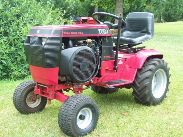

876wheelhorse 46 #1 Posted September 29, 2014 (edited) what is the difference between 300 series like the 314-8 and 400 series say the 416-8 looks like same tractor is it just motor or what. I was going to put a 16 in my 310-8 would that make it a what? Edited September 29, 2014 by 876wheelhorse Share this post Link to post Share on other sites

bmsgaffer 2,054 #7 Posted September 30, 2014 Not much... marketing mostly. Like they said, some of them had the smaller axles and lighter diffs. Other differences were the lights/gauges etc. But 90% is marketing. If you throw a 16hp in and you have the 1 1/8" axles then you have made a 416-8 for the most part. The 416 in later years had a twin Onan instead of a single Kohler. Frame, sheet metal and all other mechanical parts are exactly the same. The differentiation between series' were never very clear and changed from year to year. 1 Share this post Link to post Share on other sites
