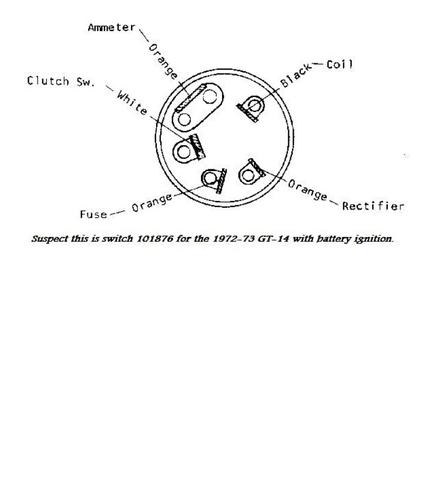

Erik the Red 0 #5 Posted September 29, 2014 Well here is what I have so far. I have 11.24 volts at Pos on the coil when key is @run and start. The switch is part number 101876 That was sudgested by a dealer I went to. He saw mine and said, this is it. There is no letter near the posts. If looking at the rear of switch (where posts come out. It is the first going clock wise from top center. Just right of the 2 that have screw mounts instead of clips. The electric clutch or somewhere very close clicks loudly when key turns to start position. Could the wires coming off of the clutch/fly wheel have any thing to do with it? Share this post Link to post Share on other sites

gwest_ca-(File Mod) 12,325 #7 Posted September 30, 2014 This picture of some switches posted in a 1972 service bulletin did not have them identified by part number. Through the process of elimination I think this is the 101876 switch. Garry Share this post Link to post Share on other sites
