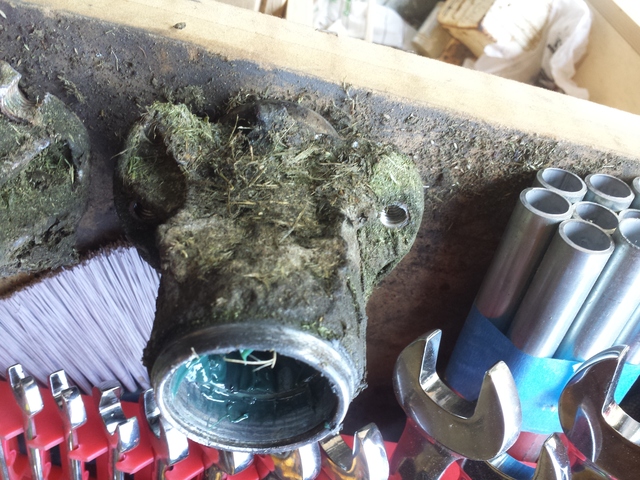

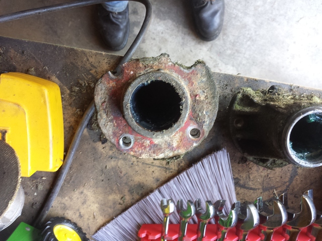

KyBlue 655 #2 Posted July 25, 2015 (edited) A bit of a update for you ... rust repair is done! however when I put the shell back together I noticed the blades were uneven (the cause of it cutting like poo) ... after scraping away the grass and debris around the spindles ... I found half missing spindles! Two of the four bolts were gone on one, and the other only only had three...Pics are coming Edited July 25, 2015 by KyBlue Share this post Link to post Share on other sites
PaulC 342 #4 Posted July 25, 2015 Unfortunately this is pretty common stuff but fortunately your deck shell really isn't that bad. I have a couple spindles housings messed up like yours on a deck I'm fixing. Mine still have about half a hole and I was thinking of going with a longer bolt and putting a nut on the back? Spindle housings are not cheap!! Good luck with your repairs and keep the pics coming. Share this post Link to post Share on other sites
bmsgaffer 2,069 #5 Posted July 26, 2015 Thanks for the update Blue.I have had a couple spindle housings rot away like that and the grass makes them look whole!Looking forward to following progress! Share this post Link to post Share on other sites
slammer302 2,157 #6 Posted July 26, 2015 I have a good housing i would sale if you are intrested KyBlue Share this post Link to post Share on other sites
KyBlue 655 #7 Posted July 26, 2015 Already have the housings - I needed two so I reached out to someone who I knew would have them... sadly now I'm waiting for two bearingsI did find quite a few cracks in the Shell under the pullies. Ground them out a bit and welded them up. More pics when my bearings come in.6203-RS1 if anybody needs the # (the 6203-2RS won't fit so beware) Share this post Link to post Share on other sites
