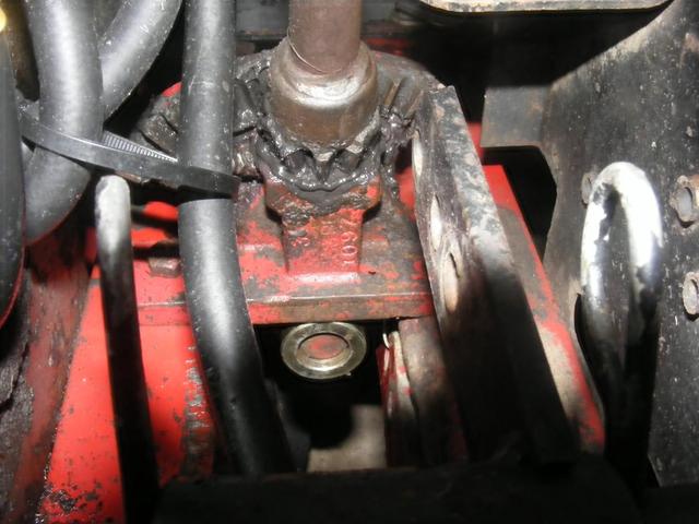

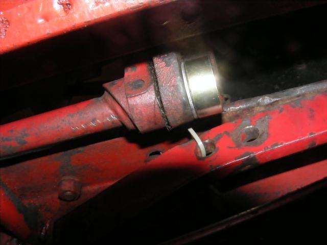

bo dawg 517 #1 Posted September 28, 2014 I thought my C-175 was a big tractor, but dog gone this C-195 is a monster of one. Love it! Mowed for a while with it today and was pretty sweet, been better if it was a 5' deck instead of 4'. It does have a problem with the steering. Other than being a bear (2 handed) to turn, it will make a pop noise if you're not rolling much at all. Not sure what is popping but thinking its at the gear at end of steering shaft skipping a tooth. 4 Share this post Link to post Share on other sites

Brrly1 1,146 #4 Posted September 28, 2014 Good looking tractors. Just guessing but it sounds like slop in the steering possibly some spacers might be needed or maybe everything is wore out. You might have to replace a part or two. Hopefully Not. Does it happen when you got the steering wheel cranked all the way? I've got a GT14 that does the same thing. Steering gear on the shaft going past the big fan gear will make a big pop. Share this post Link to post Share on other sites

bo dawg 517 #7 Posted September 28, 2014 Good looking tractors. Just guessing but it sounds like slop in the steering possibly some spacers might be needed or maybe everything is wore out. You might have to replace a part or two. Hopefully Not. Does it happen when you got the steering wheel cranked all the way? I've got a GT14 that does the same thing. Steering gear on the shaft going past the big fan gear will make a big pop. No it will pop soon as I start turning, basicly putting pressure on it. But only when stopped or barely rolling along, manuvering around or turning around in tighter places. If that makes sense. I jacked up the front end and checking for anything obvious and there is some looseness at the pin that gos thru the axle, not sure how tight it should be though. and seems like some looseness between the steer shaft and the fan gear part. Share this post Link to post Share on other sites
AMC RULES 37,196 #8 Posted September 28, 2014 So, no tooth damage on either, the fan or pinion? Share this post Link to post Share on other sites

bo dawg 517 #12 Posted September 28, 2014 So, no tooth damage on either, the fan or pinion? No not that I can tell by feeling around on it. Maybe some wear, the teeth feel smooth on edges maybe not as crisp edge as should be. How much slop should the axle have at the pin? I dont think that would cause the poping noise but good to know. Share this post Link to post Share on other sites
chipwitch 73 #13 Posted September 28, 2014 I have that popping sound on my C-125. Only happens when you get close to full left or full right while sitting still. Feels just like you described... like a tooth jumping a gear. I'm far from an expert, but my steering gets difficult to turn just before it "pops" which I am guessing puts too much stress on the steering gear. You say yours is a bear to turn. Maybe it's because of too much stress caused by the spindles sticking in the axle. I'd check to see if something in the steering is dragging. Jack up the front to see if it's still difficult. Even just a light drag could be causing the gear to skip a tooth for such a big machine while standing still. Just a thought. Share this post Link to post Share on other sites
bo dawg 517 #14 Posted September 28, 2014 I have that popping sound on my C-125. Only happens when you get close to full left or full right while sitting still. Feels just like you described... like a tooth jumping a gear. I'm far from an expert, but my steering gets difficult to turn just before it "pops" which I am guessing puts too much stress on the steering gear. You say yours is a bear to turn. Maybe it's because of too much stress caused by the spindles sticking in the axle. I'd check to see if something in the steering is dragging. Jack up the front to see if it's still difficult. Even just a light drag could be causing the gear to skip a tooth for such a big machine while standing still. Just a thought. I did that and everything is so free to turn almost effortless. Mine will pop just starting to turn. Share this post Link to post Share on other sites

shallowwatersailor 3,214 #17 Posted September 29, 2014 The steering support for the steering wheel shaft may be worn. If it hasn't been greased regularly (missed most of the time by PO,) it may be egg-shaped and allowing the vertical steering shaft to move. I had the same problem on one of my 520-H but used a 3/4" collar instead of the cotter to keep it tight to the sector gear to see if it eliminated the problem. I later replaced the support. 1 Share this post Link to post Share on other sites
bo dawg 517 #18 Posted September 29, 2014 Good idea John, I will check that out! Thanks Share this post Link to post Share on other sites
bad medicine 1 #19 Posted October 19, 2014 my c-195 had the same problim to solve it i just put washers made from shim stock beyween the cotter pin and the shaft carrier worked like a charm for me might just work for you to 1 Share this post Link to post Share on other sites
