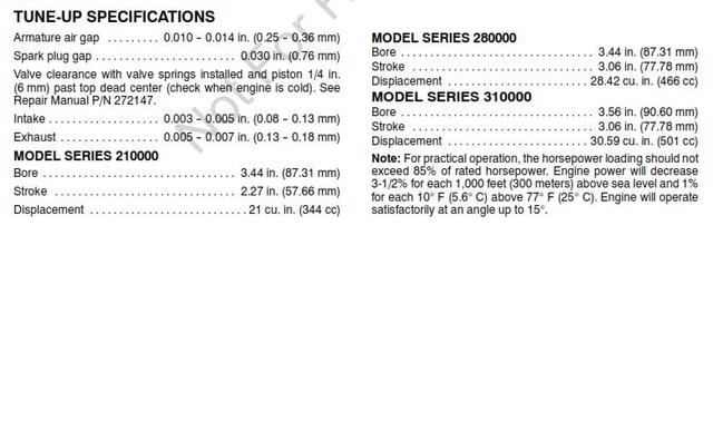

gwest_ca-(File Mod) 11,888 #11 Posted September 27, 2014 Valve clearance is critical on these engines. Garry Share this post Link to post Share on other sites
