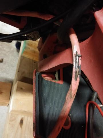

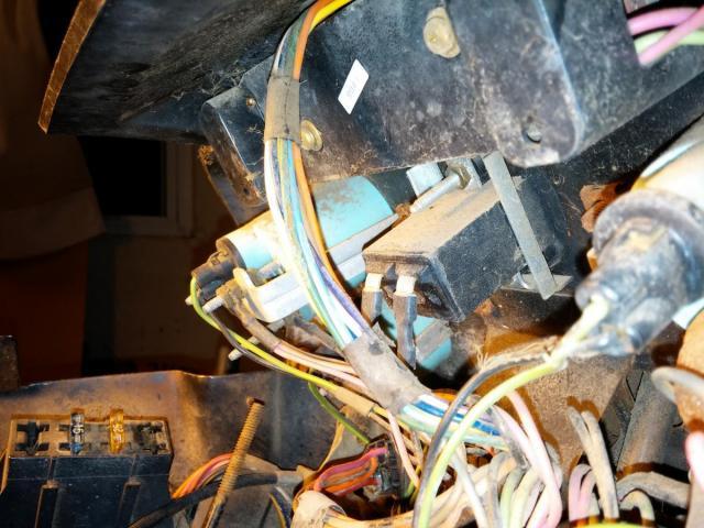

bmsgaffer 2,054 #36 Posted October 3, 2014 (edited) 'Did some digging into the electrical of this machine tonight: (Its hard to see in the picture on the right, but if you look at the closest wires that are blurry, the copper strands are separated from the insulation from wear.) I think it was by the grace of God that this tractor had not yet burned itself to the ground. That high gauge battery wire had scratched away on a plastic shroud (merely an inch from the iron chassis, just under the fuel pump... which would have been certain fiery death ), and the gauge light wires somehow were worn of their insulation (both pos and neg) and yet had magically not touched each other... The 30A fuse was missing (and had melted contacts, as usual) and was bypassed. I know that's why its not charging and thus the regulator is probably bad too. I think it is also contributing to my other electrical problems along with a touch and go ignition switch and other corroded contact... this'll be fun! Edited October 3, 2014 by bmsgaffer Share this post Link to post Share on other sites
Geno 1,930 #37 Posted October 3, 2014 The electrical design on those things really suck. Don't forget to check the 9 pin connector (main engine disconnect) they are a lot of trouble. 1 Share this post Link to post Share on other sites
