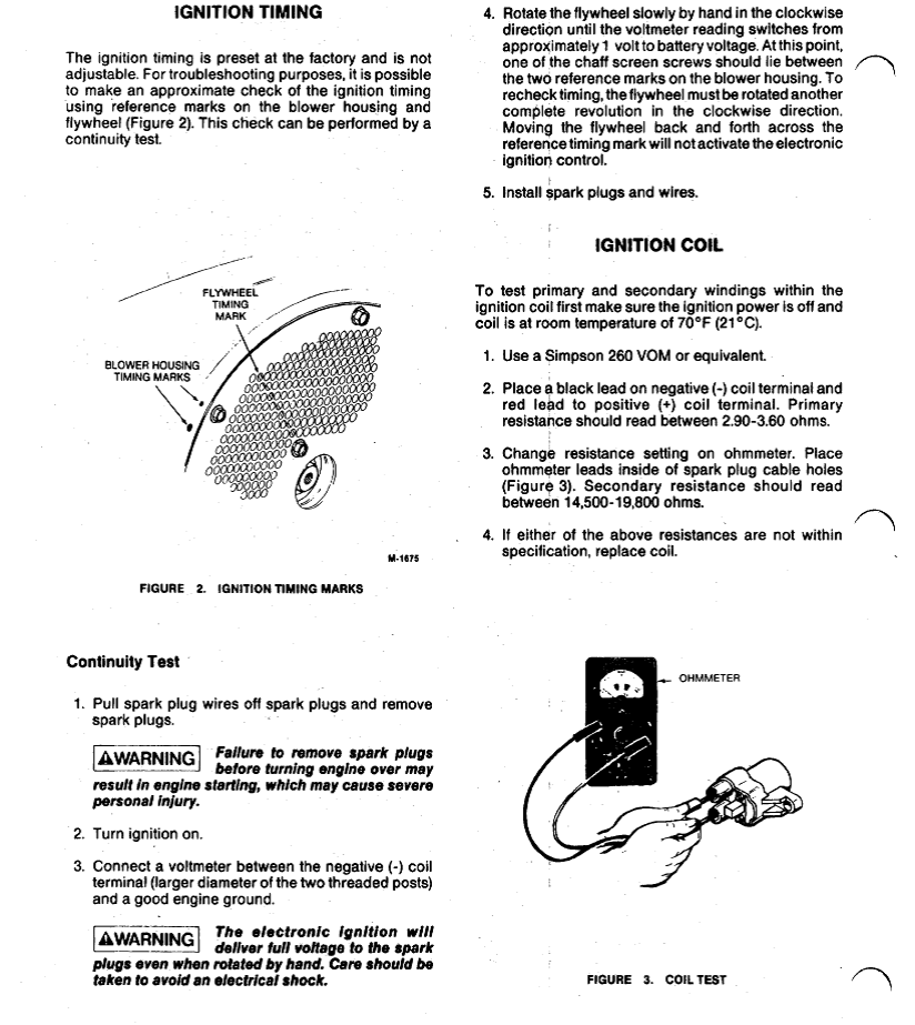

km3h 543 #2 Posted September 21, 2014 You should download the Demystification Guide from TORO. Also check the coil with a volt ohm meter. Share this post Link to post Share on other sites
km3h 543 #3 Posted September 21, 2014 This may not be your engine, but it will tell you step by step how to check the coil. Share this post Link to post Share on other sites

km3h 543 #12 Posted September 29, 2014 I have tried to find some info on your engine but can't find a wiring diagram. I think there is a ground wire on your coil. Disconnect it and see if it solves the problem. If it does, something is shorting everything out. Also check the magnets on your flywheel. They might have lost their power. Without the diagram I am working in the dark, but I believe your engine can run on it's own. Try disconnection the ignition switch and run a jumper to the starter. See if it will start. When you turn the switch off, it shorts the circuit to ground. In your case, The switch may be holding it to ground. I will keep looking for some more information and try to find a schematic. What tractor is this engine on? Share this post Link to post Share on other sites
