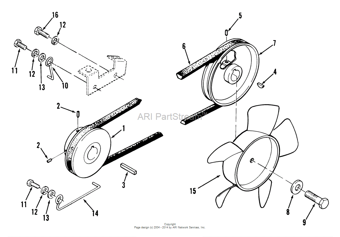

chipwitch 73 #1 Posted September 19, 2014 Is there supposed to be a fan? Looking at the exploded view diagram on parts tree, it looks like there is. Share this post Link to post Share on other sites
Save Old Iron 1,573 #2 Posted September 19, 2014 cooling of the engine is accomplished by the fins on the engine flywheel. Share this post Link to post Share on other sites
slammer302 2,157 #3 Posted September 19, 2014 If you are talking about the engine cooling fan it should be built into the fly wheel Share this post Link to post Share on other sites
ericj 1,579 #4 Posted September 19, 2014 engine or trans the hydros ran a cooling fan eric j Share this post Link to post Share on other sites
chipwitch 73 #5 Posted September 20, 2014 The fan on parts tree was for an 82. Mine's an 80. It shows a nylon fan, in case anyone is interested. Share this post Link to post Share on other sites
Save Old Iron 1,573 #6 Posted September 20, 2014 this one? cools the hydro transmission 1 Share this post Link to post Share on other sites
chipwitch 73 #7 Posted September 20, 2014 Yeah... that's the one. Share this post Link to post Share on other sites
Sparky-(Admin) 24,747 #8 Posted September 20, 2014 Yeah... that's the one. Your signature shows a C-125 8 speed. They DID NOT come with a plastic/nylon cooling fan, only the hydro or automatic tractors came with that. Mike............ 1 Share this post Link to post Share on other sites
