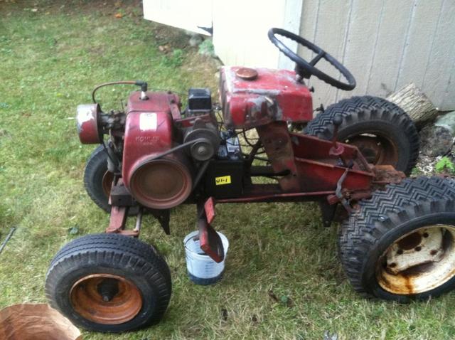

wake49 18 #30 Posted September 23, 2014 So I went home and (much to the misses' dismay) went outside to play with the engine. I drained off the old oil and put a quart of ATF in and 8 oz of MMO. The level on the dipstick was perfect. I attached the battery and cranked her over (she took a little work to get over, but got going) and no smoke! Ran like a charm. She was a little loud since the muffler was rotten and the guts fell out. I have to grab a new muffler, and I think this one will do the job: Muffler for Wheel Horse... It has a 1" female pipe thread, which is what I need and looks like a clean version of the one I have on there now. I took a short video of the engine running: IMG_0848.MOV And a Picture of her: I am going to crank her over again with the current ATF/MMO mixture and let her run again for 15-20 minutes tonight and then will drain her off. I will add the lightweight (10W40)/MMO mix for the next time I idle her. 2 Share this post Link to post Share on other sites
