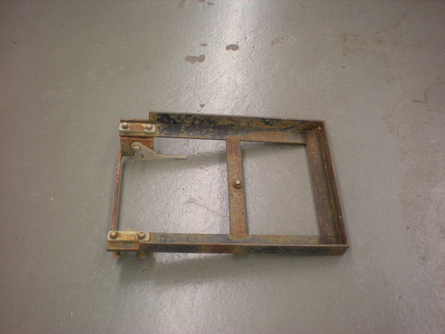

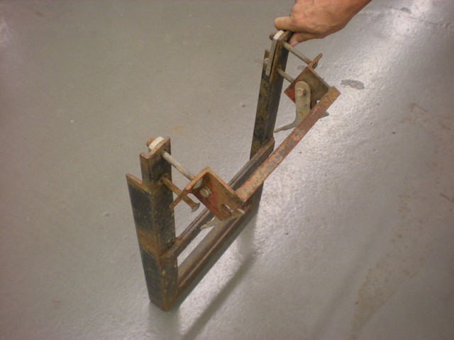

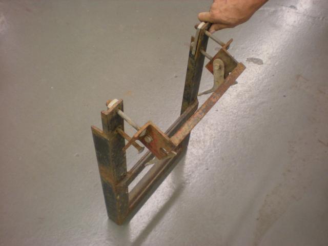

Geno 1,929 #11 Posted September 18, 2014 You can make a bracket for the rear and put anything you want on it for weight. This came with some stuff I bought somewhere. 2 Share this post Link to post Share on other sites
Ed Kennell 42,462 #12 Posted September 18, 2014 A couple advantages to the overhung weight that Geno has. The down force is increased as the weights are moved further back, and It also decreases the weight on the front wheels reducing the load on those front spindles and making it easier to steer. The disadvantage is it increases the load on the rear axles, hubs and bearings, although I doubt if this is a problem if hubs and bearings are not worn. 1 Share this post Link to post Share on other sites

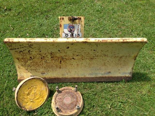

thehorse 221 #13 Posted September 20, 2014 Or....look around CL and find a set of cast or steel weights and paint them red! I've found 2 sets that way and they work and in my opinion look way better than chrome hubcaps.....but I'm not a fan of the hubcap. Share this post Link to post Share on other sites
