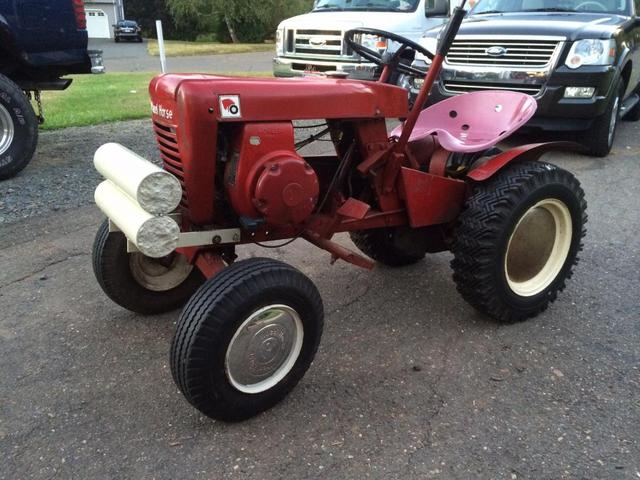

Xjchief 128 #1 Posted September 18, 2014 Was thinking of different ideas for a front weight on my 633 and this is what I came up with. Simple yet effective. It weighs 40lbs and it's made from flat steel stock and concrete filled lolli columns. Just had them around the house. The best part is if I need more I can jus weld on what I need. 5 Share this post Link to post Share on other sites
Wayne 28 #2 Posted September 18, 2014 great idea! original thinking score 9.5 1 Share this post Link to post Share on other sites
oldredrider 2,553 #3 Posted September 18, 2014 Paint them red and your score goes to 10! Great idea, thanks for sharing. 3 Share this post Link to post Share on other sites
Geno 1,929 #4 Posted September 18, 2014 That's one way to clean up around the house and recycle at the same time! Share this post Link to post Share on other sites
AMC RULES 37,221 #5 Posted September 18, 2014 Good idea there. Share this post Link to post Share on other sites
JERSEYHAWG / Glenn 4,499 #6 Posted September 18, 2014 Live and learn, clean and nice looking. The best part,,,,,,, it works. Glenn Share this post Link to post Share on other sites
KC9KAS 4,744 #7 Posted September 18, 2014 Very good & practical idea! Share this post Link to post Share on other sites
Tankman 3,523 #8 Posted September 18, 2014 Score 90 points. Red paint add 10 points! Nice job, good idea too! Share this post Link to post Share on other sites
stevebo-(Moderator) 8,557 #9 Posted September 18, 2014 I would grind the concrete smooth on the ends and paint red. It will almost look factory Share this post Link to post Share on other sites
cleat 7,474 #10 Posted September 18, 2014 Even double as a bumper Cleat Share this post Link to post Share on other sites
