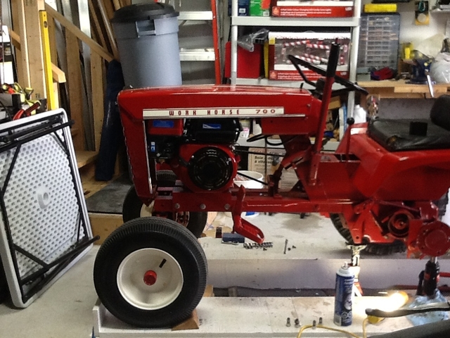

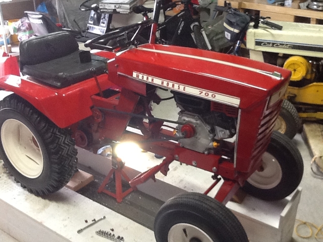

northguy 10 #1 Posted September 14, 2014 I want to use this tractor to pull an aerator and dump cart. Did not want to wear out or brake the stock motor so I put this new one in and kept and put away the oldie but goodie stock motor if I want to make it stock again. But now I have a problem. The motor works great but when you try to put it into gear (any gear) she will not go. Just starts to grind. The brake works, but it seems like no clutch. It worked before the motor switch. I did have to put a smaller belt on it. Still seems to be a lot of play. In fact I can pull the belt off the motor pulley pretty easy when brake is pushed down. Any ideas? Not really sure how the clutch works on this. Can someone give me the simple explanation? Is the belt to big? Thanks, really want to drive her around. Share this post Link to post Share on other sites

northguy 10 #7 Posted September 15, 2014 I should mention that I put a new but smaller belt on it. So what i am getting from the response is that i have to get the belt to stop so it can be shifted into gear. Not sure what I did wrong yet, will have to look at it again. and try to see why it is not stoppimg. I just took the pully guard off so the belt could be seen in the photo. Share this post Link to post Share on other sites

northguy 10 #12 Posted September 16, 2014 Thanks for all the tips. I put the cover back on and still cant get it to slow the belt down. I went down 2 inches on the belt size cause the stock belt was too big. Not sure how I am going to solve this problem. The cover is not as close to the guard as it should be cause of the differance in the new motor. It sits higher in the frame then the stock motor. I guess a smaller belt would be worse cause it would be to tight. Anyone done a motor change that had this trouble of not being able to **** into gear? I am thinking now that I may have to fab a new belt cover. Not looking forward to that. Any more ideas? Thanks guys. Share this post Link to post Share on other sites

northguy 10 #14 Posted September 17, 2014 I made the motor mounts and used existing holes in the frame. It does sit a bit higher then the stock motor. And I had to change to a smaller belt. Any idea of how I can make it work? I am thinking that I may need to make a new belt cover.. Share this post Link to post Share on other sites

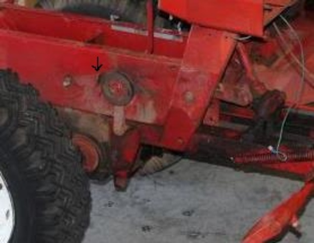

stevasaurus 23,274 #21 Posted September 17, 2014 To explain what happens here...the belt guard has some tabs welded or fastened on the inside...when you depress the clutch pedal, the tension pulley puts slack in the belt...this slack is funneled toward the engine pulley enabling the engine pulley to turn freely while the belt stops rotating...this means the the input pulley on the transmission stops turning and you can shift gears with out grinding. Try this...it takes 2 people. With the guard off, take 2 screwdrivers, and place the shafts of the screwdrivers (one on top of the belt about 2" toward the trans from the engine pulley and the other one lifting the bottom of the belt on the underside in about the same distance)...start the horse, while holding the screwdrivers in place, the 2nd person is to push in the clutch (while the trans is in neutral) and see where these screwdrivers need to be to funnel the slack so that the belt stops turning. This will give you an idea where the tabs need to be. Here are some pictures of what Walfish did for a guy at the show this last June. You may be able to form these tabs with out the guard, but it would be better to position the tabs in the guard if possible. This will fix your problem. I know this is not the set up you have, but the idea is the same. You will have to do some fabrication, but should not be that hard...the screwdriver thing will put you in the ballpark. Hope this helps. You will also need the right length belt that allows all this to happen...sounds like you already have a couple of choices. 1 Share this post Link to post Share on other sites
