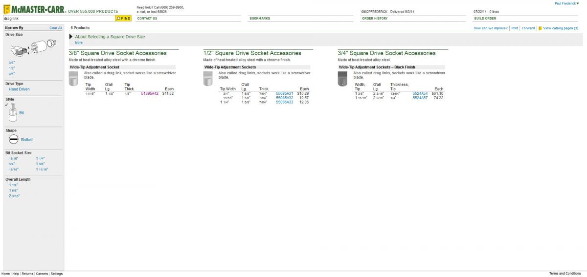

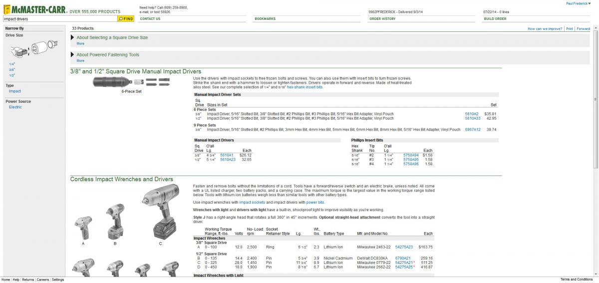

redhead 10 #17 Posted September 15, 2014 The sudden onset of your problem would seem to indicated a problem with relief or check valves. The change in pressure cold to hot seems to be a bit large. The good news is pulling the hydro pump on your c series is a whole heck of a lot easier than on a D series. Once the pump is off working on it doesn't require anything special in tool world. (The hydro motor does require a press to completely disassemble)...but you can access the acceleration valves with out that. I am having trouble getting the slotted plugs out of housing to check check valves. what is a good way to get them out? THANKS Share this post Link to post Share on other sites
pfrederi 18,856 #18 Posted September 16, 2014 I have used lots of kroil/PB Blaster,drag link sockets and also a hand impact tool They are recalcitrant sometimes. Share this post Link to post Share on other sites
