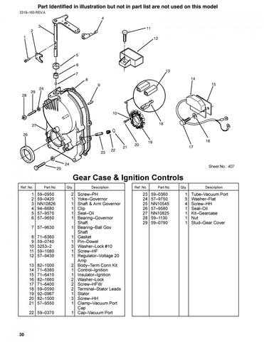

km3h 543 #26 Posted September 8, 2014 How about this. Part number 71-6380. Share this post Link to post Share on other sites
Theroundhousernr 590 #27 Posted September 8, 2014 (edited) Since you say both coils test fine. I would not worry about the coil. Go to the post Martin put up again and read the step by step instructions I posted on testing the module outside of the flywheel. If you follow these instructions, you will know if the ignition module is the culprit. There should be a better test for the ignition module but I know of none right now. I am working on it. The Kohler iginiton module from back in the 70's you could test with a flash light tester and a screw driver. But that was a different animal. "SCR" I think the onan is something along the lines of a Hall Effect sensor.... I think.... lol Give it a try. Worked for me! Kyle Edited September 8, 2014 by Theroundhousernr Share this post Link to post Share on other sites
Jess 29 #28 Posted September 8, 2014 How about this. Part number 71-6380. yes that is it! with the to wires coming out of it. Is this for a wheel horse 518H onan motor? and can this be cross reference with some generic type (Cheeper) Share this post Link to post Share on other sites
