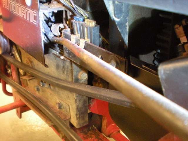

Molon_Labe 731 #2 Posted September 5, 2014 This should help 1 Share this post Link to post Share on other sites

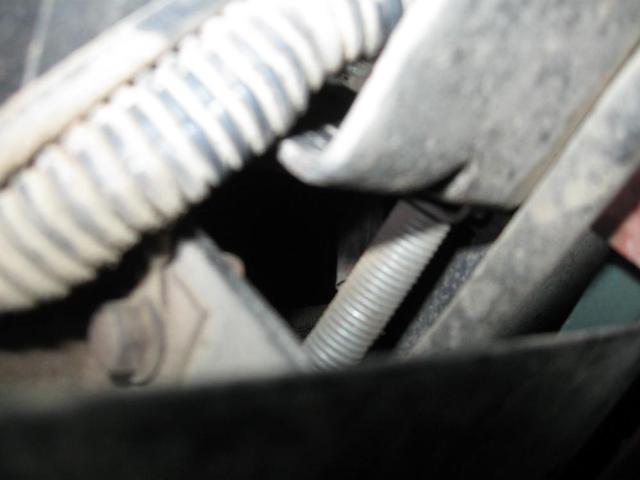

Solex 27 #4 Posted September 5, 2014 That's right N3PUY because I found the spring under the battery tray. But can you be more specific regarding that notch or even provide a picture if there is enough room to actually see in there? 1 Share this post Link to post Share on other sites
N3PUY 1,031 #5 Posted September 5, 2014 That's right N3PUY because I found the spring under the battery tray. But can you be more specific regarding that notch or even provide a picture if there is enough room to actually see in there? Very difficult to reconnect .... the notch is just a little (1/8") circle in the corner of , I'm thinking, the right rear corner of the battery tray. You really can't see it. I'll look at my 416 this evening, it's like that. My C125 has it at front. You could always modify it to look like Bailey's picture. Joe Share this post Link to post Share on other sites

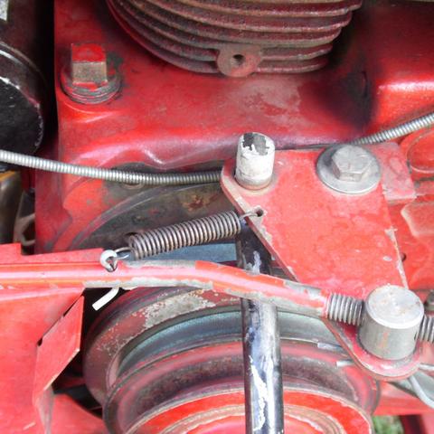

Geno 1,930 #6 Posted September 5, 2014 On my 414 and 417 they connect to the cotter pin through the shaft, then to a hole in the rear of the fuse block bracket here - Share this post Link to post Share on other sites

N3PUY 1,031 #8 Posted September 5, 2014 Yeah! Even my 416-8 is different. It is attached to the belt guard bracket and the spring looks smaller diameter. Share this post Link to post Share on other sites
