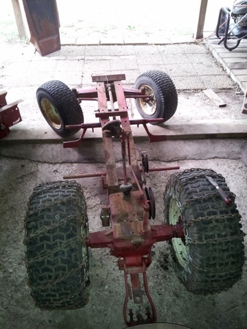

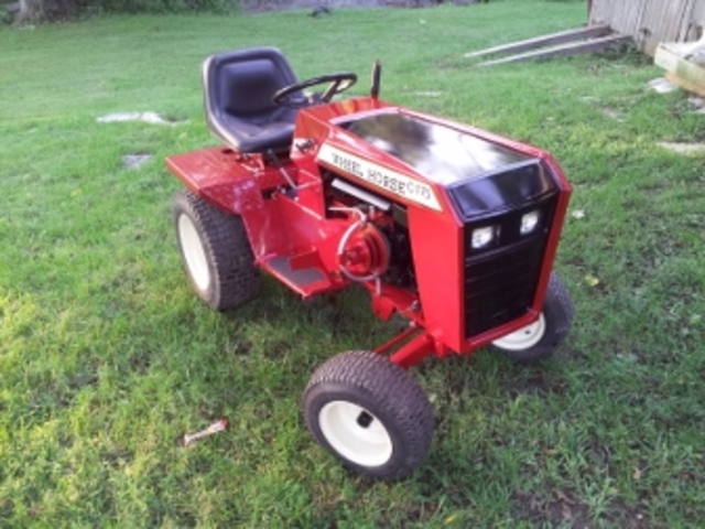

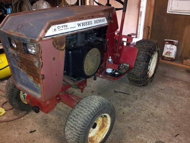

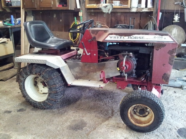

aboutime 9 #1 Posted September 3, 2014 I AM NEW TO THE WHEEL HORSE. BUT I PICKED UP TWO C-175 BACK IN JULY ONE RAN AND THE OTHER NEED A COIL. ANYWAY I USE A COIL OFF A GM CAR AND TWO CONDENSERS AND A BALLIST RESISTER, WORKS GET. I HAD TO MAKE A FEW PARTS FOR THE TRACTOR LIKE THE BELT GUARD ,FOOT REST AND THE REAR FENDERS. THE PICTURES WILL HAVE TO COME IN SPIRTS BECAUSE OUR INTERNET IS TOUCHY. 1 Share this post Link to post Share on other sites

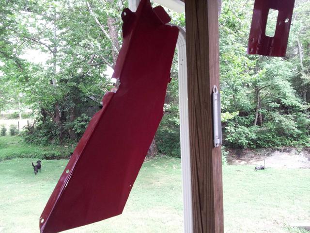

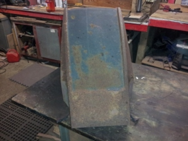

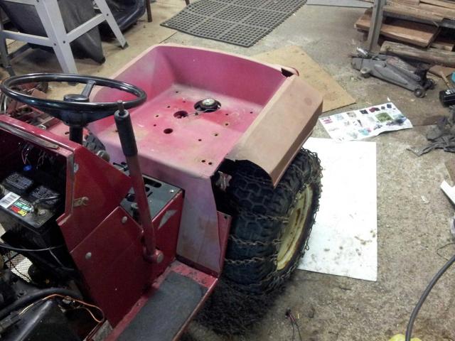

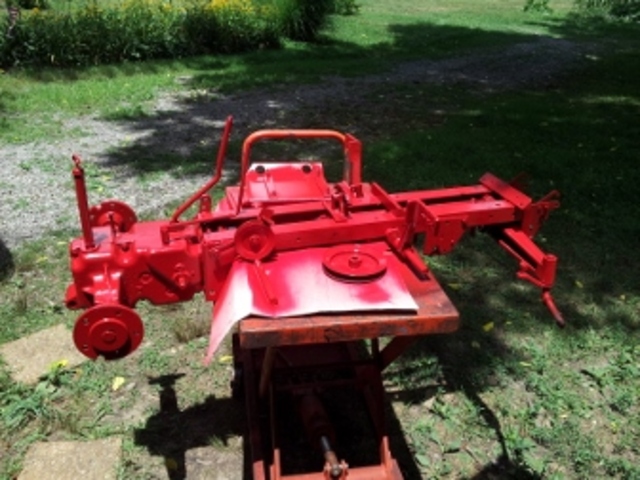

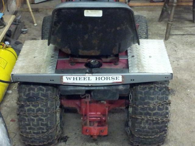

aboutime 9 #6 Posted September 6, 2014 just to let everybody no that this restore is already done . finished it a few weeks age. but I want to share what I did and how I did it. I made the belt cover out of a Mustang quarter panel. the foot rest was made out of running boards off a chevy pickup the fenders I also made out the running boards. Here is a few pictures. Share this post Link to post Share on other sites

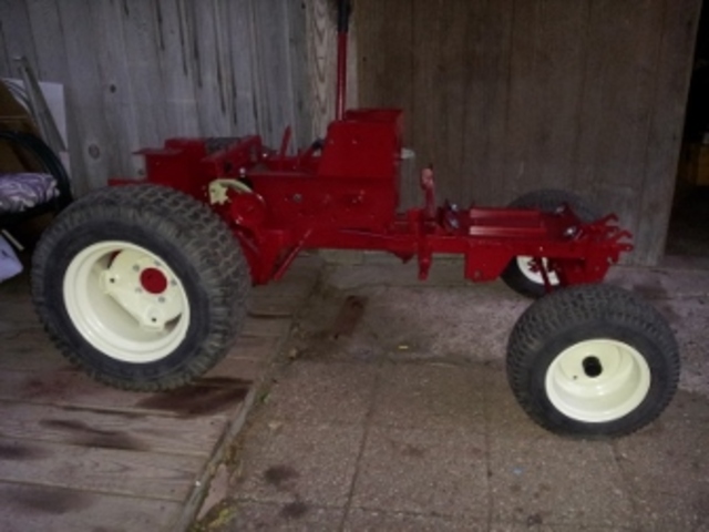

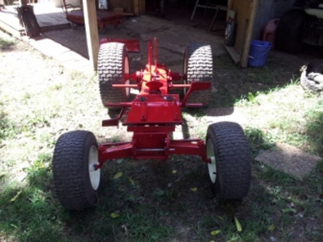

aboutime 9 #7 Posted September 6, 2014 Here a rear view after I got the parts made and got it running, right I took it apart. it came apart pretty easily thankfully. Share this post Link to post Share on other sites

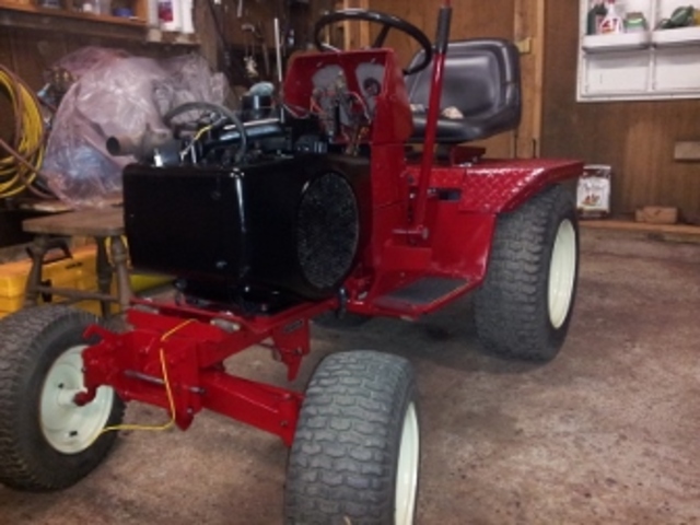

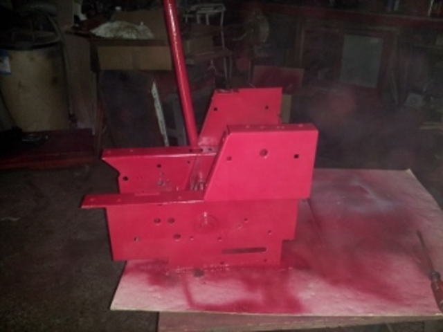

aboutime 9 #12 Posted September 10, 2014 Here is a few pictures of the progress. I started out using Valspar Cut Ruby. I was not to impressed with drying time and overspray. So I went to Krylon Cherry Red dried faster and very little overspray. I used Rustleum Almond white on the wheels. Not sure if they needed to be white or off white but the almond looks pretty good. I had to weld up the center portion due to cracks. 1 Share this post Link to post Share on other sites

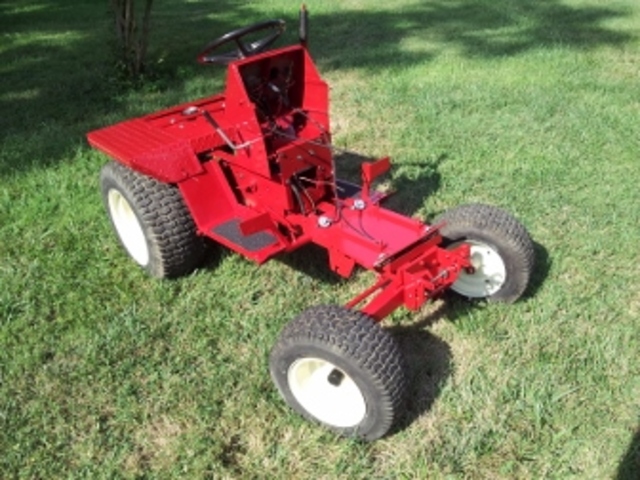

aboutime 9 #15 Posted September 18, 2014 few more progress pictures. I my still may try and something different with the fenders. 1 Share this post Link to post Share on other sites

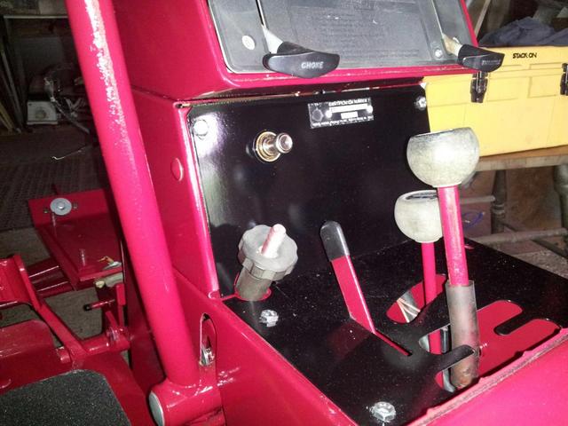

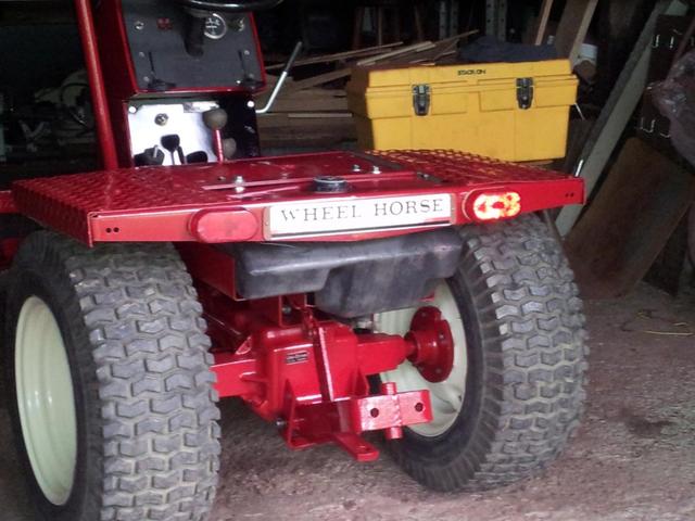

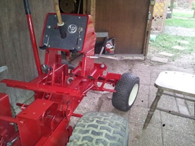

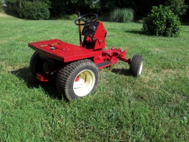

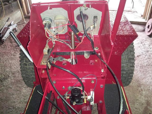

aboutime 9 #17 Posted September 21, 2014 FEW MORE PICTURES THIS MORNING. THE TRACTOR HAD A RATS NEST OF WIRING WHEN I GOT IT. THE FIRST OWNER AN A FUSE PANEL 8 INCHES LONG AND HAD A TRAILER HOOK UP AND REAR SPOT LIGHTS. I CLEANED IT UP HERE IS FINSHED PICT OF BEHIND THE DASH. THIS TRACTOR HAD A CIGARETTE LIGHTER. DOES ANYBODY KNOW IF THIS CAME WITH A LIGHTER OR WAS IT INSTALLED LATER? I NOW SOME OLDER ONES CAME WITH CIGARETTE LIGHTERS. ANYWAY I HOOKED IT UP. HERE IS A PICTURE WITH THE ENGINE INSTALLED. WHEN I GOT THE TRACTOR I WAS TOLD THAT IT HAD NO COMPRESSION. I HAD TO TRY IT FOR MY SELF. ONLY THING I FOUND WAS THAT IT HAD NO SPARK. SO I USED THE IDEA OFF OF BRIAN MILLER WEB SITE. I LEARNED ALOT FROM THAT SITE. TRACTOR FIRED RIGHT UP. THE ENGINE HAS SOME VALVE SMACKING NOISES I HOPE THIS IS OK. I REALLY DO NOT WANT TO GET NEW VALVES AT THIS TIME. I DID TAKE THE HEADS OFF TO CHECK FOR CARBON. I STILL CAN SEE THE HONING MARKS IN THE CYLINDER WALLS. I ASSUME THAT IS A GOODTHING. THE REAREND I CUT THE OLD WHEEL HORSE LOGO OFF OLD PLASTIC FENDERS AND I ALSO REUSED THE LIGHTS. LOOKS PRETTY GOOD FOR NOW. THE REAR PART THAT HAS THE LIGHTS AND LOGO ON IT CAME FROM LEGS OFF A TABLE SAW. THE BELT GUARD WAS HOMEMADE THE METAL CAME A 67 MUSTANG QUARTER PANEL. I USE WHAT EVER I CAN TO SAVE MONEY. THE NEXT PART IS GOING TO BE THE HOOD "WHAT A MESS". 1 Share this post Link to post Share on other sites

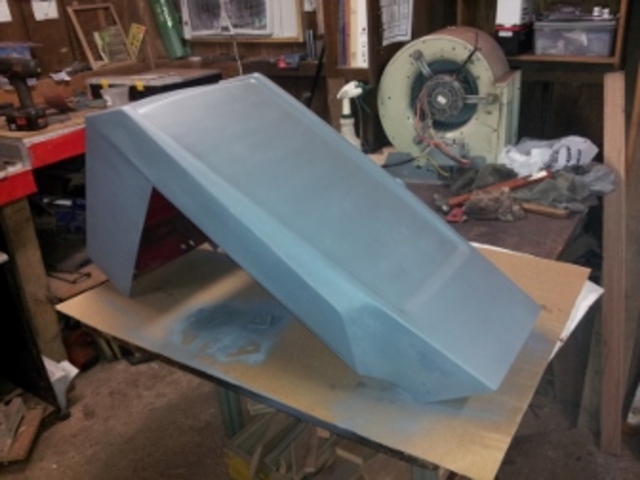

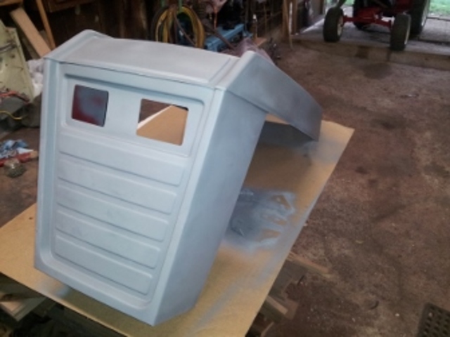

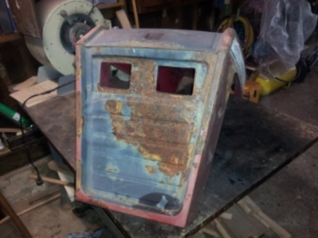

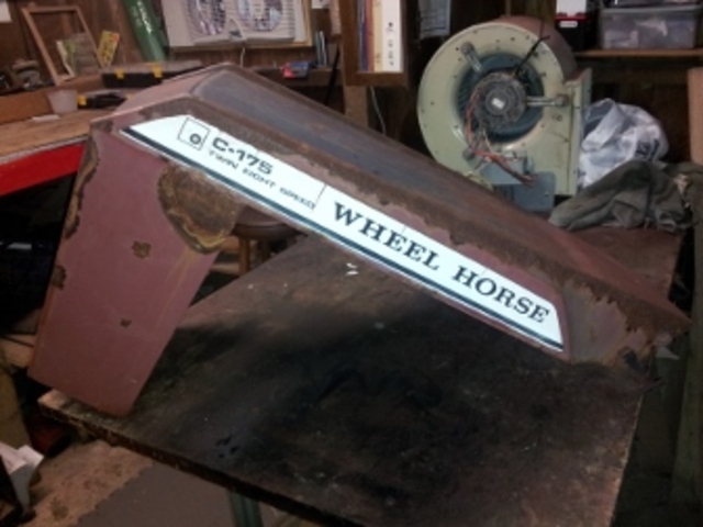

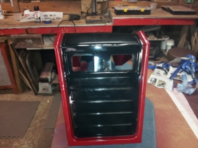

aboutime 9 #19 Posted September 28, 2014 THANKS GENO. IT HAS BEEN FUN, I REALLY ENJOY RESTORING OLD EQUIPMENT. HERE IS A FEW MORE PICTURES OF THE HOOD. 3 THE PAINT WAS VERY DIFFICULT TO REMOVE. THE MORE I SANDED THE WORSE IT GOT. I ENDED UP HAVING TO USE PAINT REMOVER. THE HOOD WAS NOT PERFECT IT HAD ALOT OF PITS FROM THE RUST. I REALLY DID NOT WANT TO USE BODY FILLER, SO I WILL HAVE TO LIVE WITH IT. I WILL DO MY OWN DECALS. I KNOW THAT YOU CAN BUY THEM PRETTY CHEAP BUT THIS IS A BARGIN BUILD. 3 Share this post Link to post Share on other sites

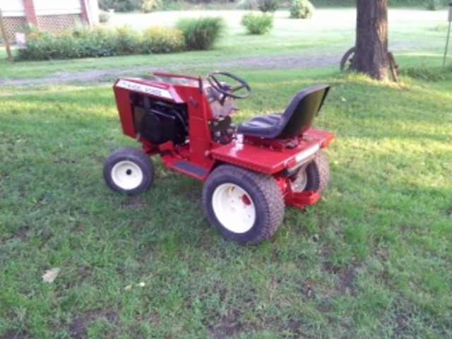

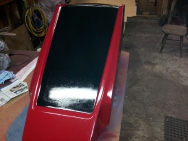

aboutime 9 #22 Posted October 3, 2014 I GOT THE HOOD DONE. WHAT I DID WAS I PAINTED A BLACK STRIP FIRST, THAN I PUT MY LETTERING ON THE BLACK , TAPED OFF THE HOOD AND PAINTED IT WHITE. THAN I PEELED OFF THE LETTERING TO SHOW THE BLACK. I KNOW THAT IT IS NOT RIGHT BUT LOOKS GOOD FOR ME THE ONLY PROBLEM I HAVE WITH THIS TRACTOR IS ONE OF THE REAR HUBS IS WORN WHERE THE KEY IS. 1 Share this post Link to post Share on other sites

bo dawg 565 #25 Posted October 5, 2014 can you take a closer pic of your custom hood decal look? Share this post Link to post Share on other sites
