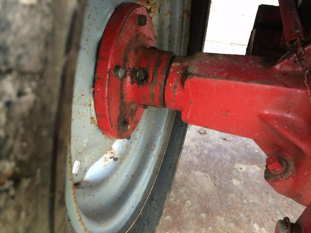

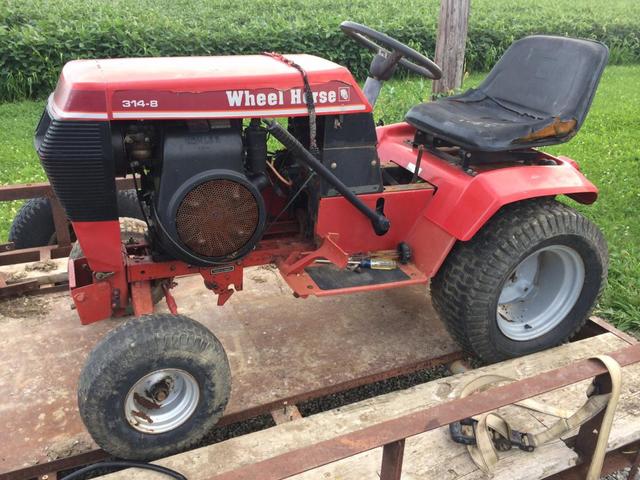

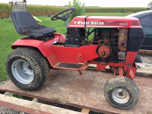

876wheelhorse 46 #1 Posted September 3, 2014 Picked this tractor up guy said it ran 2 years ago.... I hope it did at least it had good compression by hand. Rear tires been flat and dry rotted. They held air a hour tops. I pulled peacock from tank and the rubber grommet was cracked not a drip in tank. Somehow both set screws on hub are snapped off might be interesting to fix that. I was informed flat 1 1/8 hubs are hard to come by. So I have. Battery on charger and will get fuel line and filter. Hopefully fires up. It came with a 42 deck and blade that won't work on it... Oh it's a mystery machine no tag on it so not sure on year....hour meter don't know if it works or not only hundred some hours on it 1 Share this post Link to post Share on other sites

gwest_ca-(File Mod) 12,533 #8 Posted September 3, 2014 The model number of the tractor is 21-14K801 and a 1985 model. Red decal on the hood is pre-1990. They didn't build another 314-8 until 1993. Garry Share this post Link to post Share on other sites

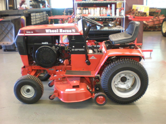

Geno 1,932 #13 Posted September 6, 2014 I agree with Hammer, here's one we fixed up and sold. It's a 310-8, the only difference is the Magnum engine. Share this post Link to post Share on other sites
