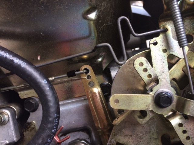

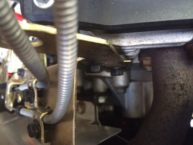

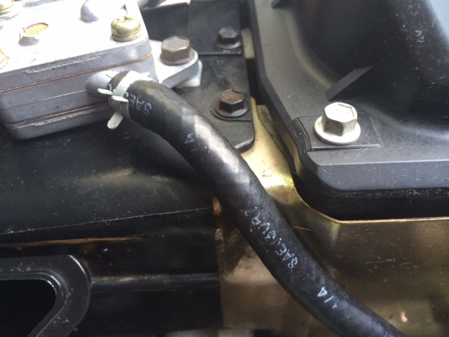

RMCIII 839 #30 Posted September 14, 2014 This is really bugging me. Challenger, I've attached 3 photos that show the brass covering for the left head. It appears to me, once this panel is removed, it will provide enough access to clean the head and any debris that has built up in the back of it. But before I jump in, I thought I would ask, have you just removed this panel before to do a "partial" cleaning? If so, anything I need to look out for? It appears to me that the panel is being held on by 4 bolts total. The issue I see is the linkage for the carb, and removing the muffler shield to gain access to the front bolt. Am I missing anything? Rob Share this post Link to post Share on other sites
JERSEYHAWG / Glenn 4,532 #31 Posted September 14, 2014 Wonder if you could poke around and clean it out with a vacuum set up of sorts???? I haven't torn into it yet. Besides doing a hundred other things I want to get the 854 done. Start on it and another job pops up. Glenn Share this post Link to post Share on other sites
RMCIII 839 #32 Posted September 14, 2014 Glenn, my thoughts EXACTLY!..... If the engine can stay in place, and the head can be cleaned, then why pull and reinstall, the engine? Just me but there has to be a much simplier way!!!! Rob 1 Share this post Link to post Share on other sites

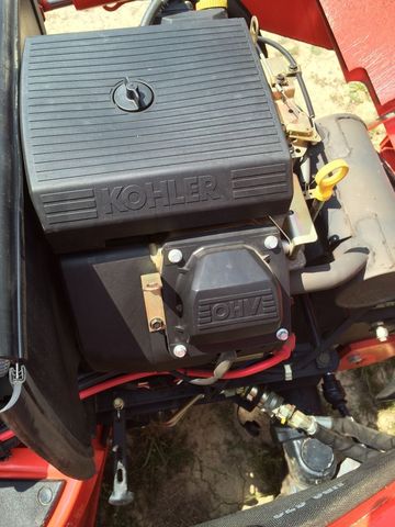

shallowwatersailor 3,220 #34 Posted September 15, 2014 I tried to take my 520xi apart last year from the top. It went well until the metal baffle on that side which is bolted to the engine under the plastic shroud. I used a vacuum, in fact I used a small plastic extension for cleaning keyboards - that slipped off and is still in there . It is as clean as I could get it and verified using my snake camera except for that one area which is unreachable as is. My engine still runs hot. I think that the head bolts are under the shroud as well. Bottom line is the engine needs to come out, or the firewall needs to move back. I only say using an engine hoist, etc., because I don't have help. Two guys can lift the engine. 1 Share this post Link to post Share on other sites

shallowwatersailor 3,220 #40 Posted September 16, 2014 Don, It's the same engine family. The Legacy is rated at 27hp so that could account for some difference. The 5xi Kohler has a muffler shield where the Legacy does not. This is a photo of the Legacy. There is NO clearance from the firewall. The engine needs to be pulled for sure. The Simplicity Legacy is what the 5xi should have been: 3-Point Hitch, 4WD option, additional hydraulics, larger tires, etc. Of course, it would have cost even more brand new. John 1 Share this post Link to post Share on other sites
