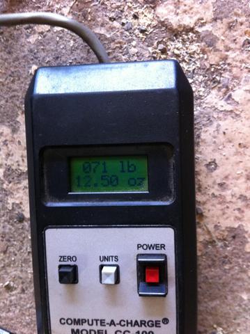

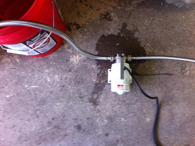

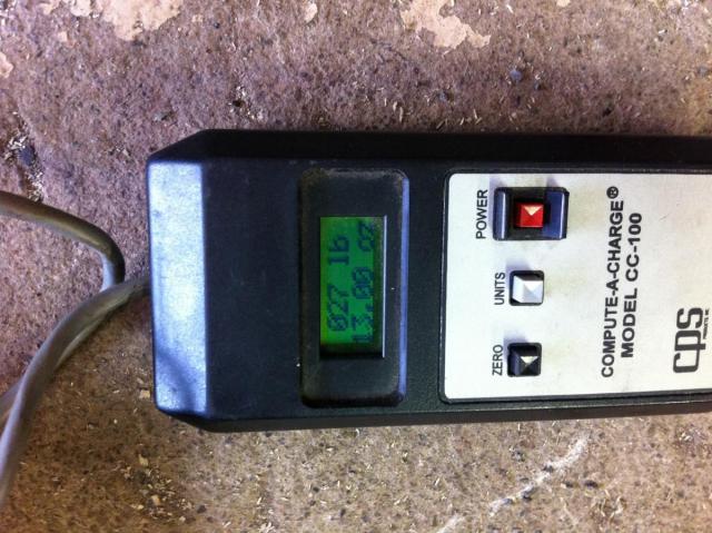

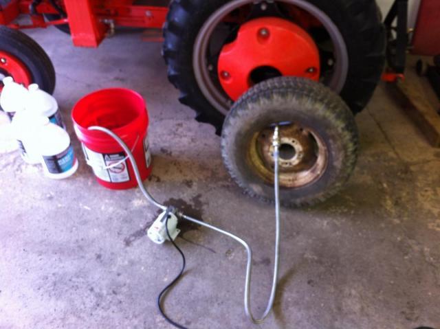

squonk 44,918 #1 Posted September 1, 2014 (edited) I'm a firm believer of filled tires for winter duty. The extra traction and momentum filled tires provide are the cats bee-hind. I had a pair of old but very healthly Silvertowns laying around and decided they should go on Ezra for snow blower duty this winter. I got the RV freeze on sale at TSC for $3.00 a gal and needed 11 gallons for the 23 x 8.50 x 12's. Borrowed a pump from work and started fillin. Tires and wheels weighed 27 lbs. each empty and now weigh 71 lbs. each. Took about 10 min a tire. I'll be adding 50 lb. WH weights and reinforced chains to these also. Edited September 1, 2014 by squonk 7 Share this post Link to post Share on other sites
