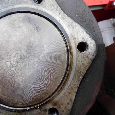

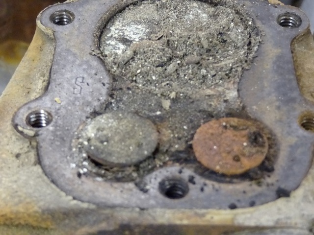

jsp_333 286 #1 Posted August 29, 2014 How about thoughts on what's inside. Pulled the head off last weekend. Pictured is what I found. Worth saving? or too badly damaged As I mentioned in previous post, flywheel turns freely, piston /valves go up and down - that doesn't mean much but it's something. What are the determining factors in deciding whether to fish or cut bait? I have no experience rebuilding an engine but I'm game if nothing else More pics required of bottom of engine, piston, crank? Also drained the oil - was pleasantly surprised to find at least 1/2 quart. 2 Share this post Link to post Share on other sites
slammer302 2,157 #2 Posted August 29, 2014 I would get the piston cylinder measured and go from there Share this post Link to post Share on other sites
pacer 3,179 #3 Posted August 29, 2014 Everything there looks fine except showing strong indication its using a lot of oil. Measure the cyl bore - you just might luck out and get by with rings. Share this post Link to post Share on other sites
Lane Ranger 11,854 #4 Posted August 29, 2014 It's a keeper! Share this post Link to post Share on other sites
stevasaurus 23,627 #5 Posted August 29, 2014 I think so also...check it out and see what you actually have...they are worth saving. Plenty of help on here to walk you through it, and the learning experience in itself is worth a million bucks. Share this post Link to post Share on other sites
Coadster32 793 #6 Posted August 29, 2014 I think so also...check it out and see what you actually have...they are worth saving. Plenty of help on here to walk you through it, and the learning experience in itself is worth a million bucks. X2 all the way. Looks like your valves move ok to the crank. Don't be nervous about the oil...(I'd be dirty too if I didn't take a bath in 40+ years) 1 Share this post Link to post Share on other sites
jsp_333 286 #7 Posted August 29, 2014 So pull the piston and get both it and the cylinder measured. O.k. I'll see about getting the piston out. What will that tell me? If they are within factory tolerances then I've got at good shot rebuilding this engine? cheers Share this post Link to post Share on other sites
stevasaurus 23,627 #8 Posted August 29, 2014 Absolutely, that will tell you everything. Use calipers to get an idea. Let us know. Share this post Link to post Share on other sites
FarmerJim 5 #9 Posted August 29, 2014 Absolutely worth saving. Ive saved a whole lot worse than that. Pop that thing apart and measure your bore, more than likely find its wore out of round find a reputable machine shop and get on a first name basis with them. only way I would never proceed is if on inspection you found any kind of a crack in the cylinder wall. I have a K 301 that has a chunk missing from the lower end of the cylinder from where a rod let loose-piston does not travel that far.had it bored .010 new internals overhaul kit from e bay and prob have 300 hours on it no trouble. your mileage may vary!. Even if it was cracked if you threw enough time and money at it you could have it fixed,but that is where I draw a line in the sand.Regards. 1 Share this post Link to post Share on other sites
AMC RULES 37,254 #10 Posted August 29, 2014 I say... fish on. Share this post Link to post Share on other sites
Geno 1,930 #11 Posted August 29, 2014 They are all worth saving, it's not like they make them any more! Share this post Link to post Share on other sites

can whlvr 994 #15 Posted August 30, 2014 save her for sure,it lokks like the rings are pretty worn hich usually meand the bore too,but it could just need a hone and rings Share this post Link to post Share on other sites
