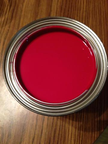

Hodge71 691 #48 Posted September 19, 2014 Heres the color guys!!! International Harvester Red #50...... I ended up getting 2 quarts Bob. I figured I gotta paint both sides of the hood, fender pan and footboards plus the belt guard for the right and the panel that covers the lift cylinder and brakes assembly on the left. I figure red should be flowing Sunday. They gave me a urethane primer/ surfacer so that will be flowing Saturday. They told me 2-4 coats of primer and 3 or 4 coats of red 10 minutes apart until it covers with no show through. Really nervous about orange peel. Its once and done so I gotta be sure to do it right. Share this post Link to post Share on other sites
