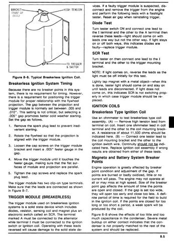

gwest_ca-(File Mod) 12,390 #34 Posted September 25, 2014 See if you recognize this Kohler manual. It has some test procedures for the coil this ignition system uses that may help Garry Share this post Link to post Share on other sites

gwest_ca-(File Mod) 12,390 #41 Posted October 1, 2014 Do you have a "flashlight tester" as mentioned in the above test for the trigger module? My guess it is just a self-powered test light. They usually have a single AA battery and bulb and very inexpensive. When the sharp probe is in contact with the clip on the tester wire the circuit is completed and lights the bulb. Since you have the original module it would be interesting to know it's condition. This type of tester is great for statically adjusting a set of points to a timing mark. If you get or have one of these testers don't forget to remove the battery when you are finished with it. They don't get used very often and the battery has likely leaked the next time you need it. Don't ask how I know. Garry Share this post Link to post Share on other sites
