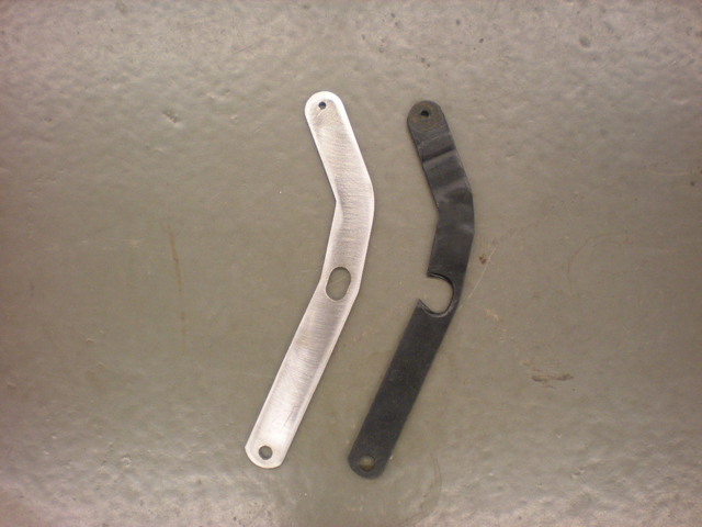

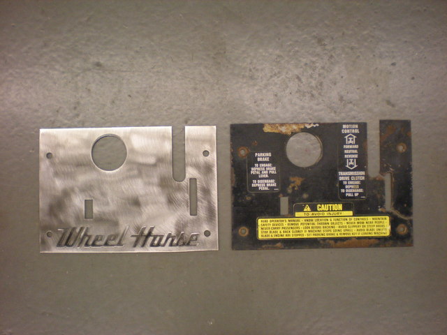

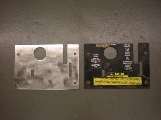

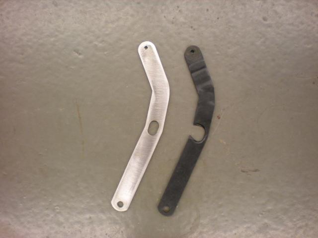

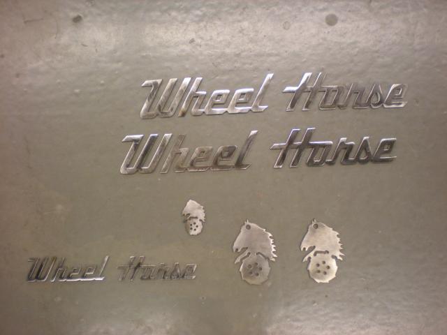

Geno 1,930 #1 Posted August 28, 2014 Anyone else had this problem? The hydro drive belt tension rod seems to still be available but not the top plate, so I ran down the street and Scot made me some new parts. He's the bomb. The top plate is now 4 times as thick and stainless. Here are some pics of before and after, new parts are still in the rough here. He also now has the unavailable top plate in his CNC plasma cutter software so he can make one for anyone who needs one out of whatever material + thickness you want. He has the rod in there too and the Wheel Horse script of course in that style you see. Terry (Vinylguy) had a hand in helping with the correct writing style for the Wheel Horse lettering part, he's the best too. 4 Share this post Link to post Share on other sites
jackhammer 550 #2 Posted August 30, 2014 Mine is elongated but not wore thru as that one and I was wondering if you had the series II - I see it is an 86 so it probably is Share this post Link to post Share on other sites

Geno 1,930 #4 Posted August 30, 2014 Mine is elongated but not wore thru as that one and I was wondering if you had the series II - I see it is an 86 so it probably is Yes it is a Series II. If it's elongated the rod may have a lot of wear in it. With the new rod installed it doesn't get anywhere near the front of the slot and it works sooooooooo easy. Share this post Link to post Share on other sites

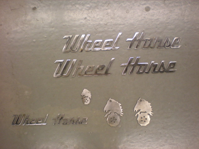

Geno 1,930 #6 Posted August 31, 2014 Spent all afternoon at Scots making Wheel Horse stuff. He said he can make the dash panel in steel for 45.00 and 403 stainless steel for 65.00. Pretty awesome for a discontinued part, I plan on having him do a lot of stainless stuff for several of my older and newer tractors and will keep you all advised on what we make. We also made some snow plow links, and some ornaments. I'll try to post them tomorrow or Monday. The 4' Horse head logo and writing is done and in the trailer thread. Share this post Link to post Share on other sites

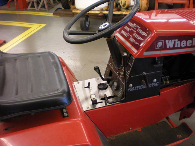

Geno 1,930 #7 Posted September 10, 2014 Here is a pic with the stainless piece installed. I still have to get with Terry and get decals for it and put the Wheel Horse logo on it. I think the front panel will be the next thing to do in stainless. Share this post Link to post Share on other sites
